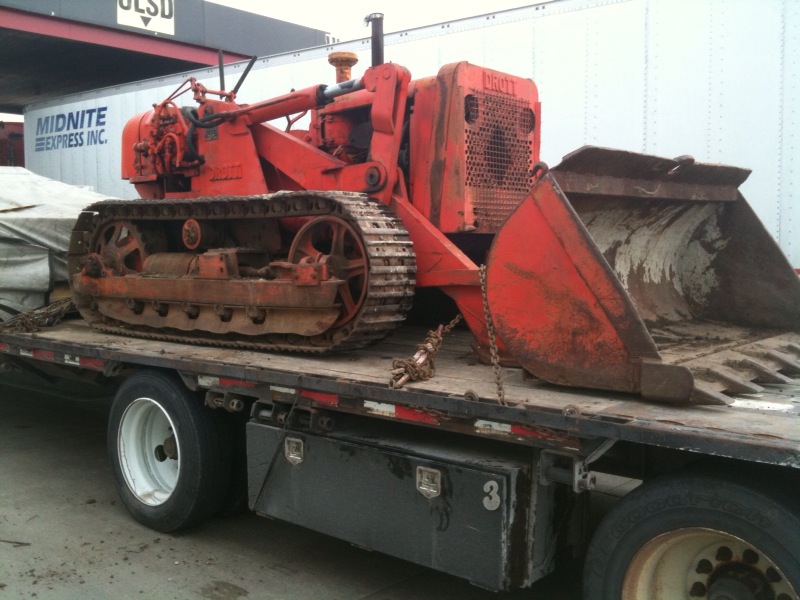

just purchased an hd5e with drott bucket,does anyone know the wix filter numbers for the oil & fuel?

Nice looking loader, it looks like Coke's machine

Looks like the E has a higher lift to the bucket with that linkage . The problem with my 5G is i need to make a ramp to load tandem dumps with sideboards .
 The filter can should have the AC filter numbers on the rim of top cover. AC Delco not  Al Chal
 Have fun with you 5E and keep it running smooth , 2-71's run wide open all the time when working it so wear ear protection.

The left sproket is in good shape, the right is pretty bad...going to try and build it up. the left brake needs adjusted,left clutch is out of adj....the motor was running on 1cyl, the fuel system hadnt been drained in avery long time....dug out enough junk to fill a qt can...now it runs great..!
