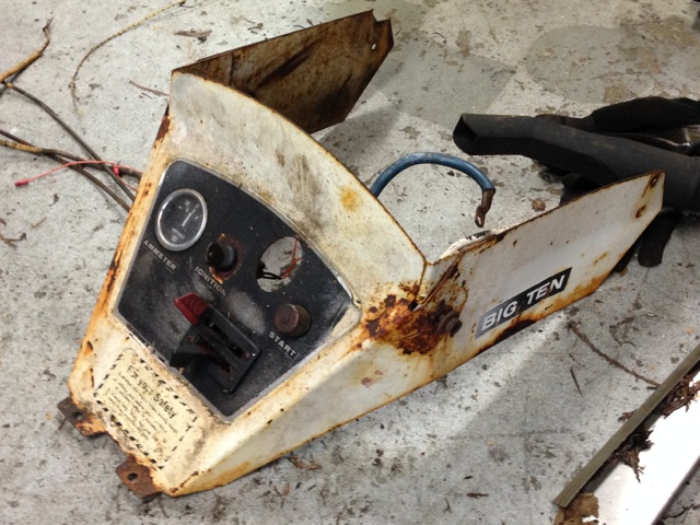

Here's a before and during of the dashboard:
More to come, as it's all going back together.  :)

I'm just working with the guys at this place to convert this kit into a BigTen:
Thanks on the dash.  That's the stock one (at this moment) cleaned up!.  I'll should be able to post back the updates in the next day or so after I've finished the mods.

Here's a plug sitting in the now unused hole for the key:
That got welded in, and ground flush (material came from cutting out the tach hole!).
Ditto for the one where the starter button was.
Ignition/start key is getting moved to the side.
Second (new) large hole is for the tach.  On that note!  Even if you order up an Equus 6086 tach, make sure it's the right version.  The one they advertise on the website says it works with 1-12 cyl engines, including DIS.
The first TWO I got from my local parts place must have been an older version.  Instructions stated to not use it with DIS, and it only worked with 4-6-8 cyl's!  Same part number though.  :/
Current slow rides: '65 Big Ten, '79 JD 317

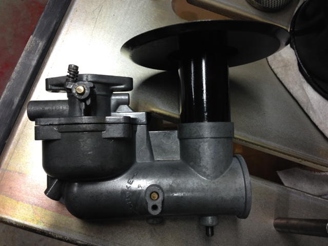

Started to refresh the carb:
Tossed it in my ultrasonic cleaner (after stripping it down!), buffed it up with a wire brush, then hit it with some clear coat (why not!).
Waiting for a carb kit to show up in the mail. Figured using gaskets and stuff would be a good plan.  Wink
This is pretty much what it looks like now:

Wow - just notice I hadn't added to this since... last month!  Wink
Still trying to resolve a carb leak.
I'm getting fuel leaking from the bowl into the main air plenum. Then it dribbles out the drain in the bottom.
Needle and seat are doing there job.
Next step is to put some water with food coloring into the bowl, with it on the bench and the top off.  It's either leaking around the conical seal between the bowl and the jet tube, or there's a pinhole in the bowl itself.
It's enough of a leak to make it drip about once every 2-3 seconds.
