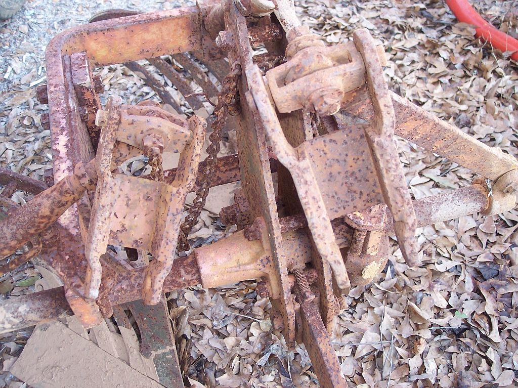

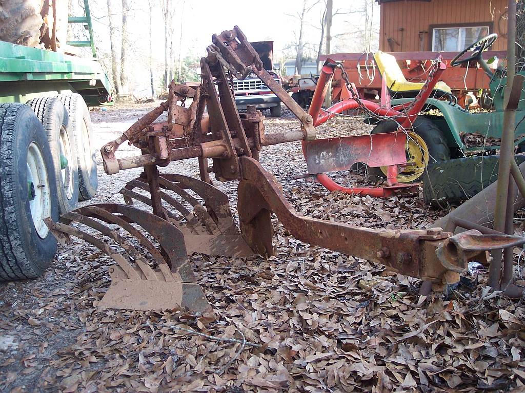

You may have seen my post about my new D14.  I bought this pin hitch plow at the same auction.  Dad wants to convert it to snap coupler to pull with the D14.  I hate to modify anything and like to keep things original.  Here is the plow.

it is a sc plow you don't need to modify it

You shouldn't have to modify it at all. All you need to do is put a SC eye on the drawbar and replace the lift arm adapters to lift arm latch adapters. The way it is set-up now is for a pin-hitch CA tractor.

If you had a snap couple plow for parts, I think all the parts that need changed would be bolt on parts. Like Jason said, you shouldn't have to modify anything. Save the pin hitch and the pin type lift arm brackets so it can be changed back if needed. Charlie

To make this work correctly, and SAFELY, you will need to convert not only the hitch to the SC eye, but also the parts that attach to the lift to make it snap coupler compatable.
If you don't, what could happen could be deadly. There have been cases (even members of this forum have incidents to talk about, if you look in the old forum you may be able to find some pictures) of the snap coupler bell accidently unlatching. What that does is creates a pivot point on the lift arms, and basicly swings the implement, in this case the plow, up into the seat of the operator of the tractor, basicly into your back, and possibly crushing you to death. Look around a little, and you will find pictures. If you use the snap coupler bell, use the snap coupler latches!!! They will release if the implement were to start to swing up, thus disconnecting the entire implement from the tractor and preventing the whole thing from swinging up into you.

To convert the CA plow to a snap coupler, as other have said you need the front piece.  The lift links are completely different, not just the top piece, down to the horizontal bar.
Listen to morton, convert it all not just the front hoop.
Looking at the pictures, you are missing the front coulter and coulter mount.

 You would probally be better off finding a snap coupler plow and selling that one as a pin hitch plow. Bolting on a snap coupler eye sets that plow too far back by about 4", you could saw 4" off the beam but then its gone & makes it harder to convert back someday,as stated above plow lift arms are different lengths from a WD to a D series and I have also heard that a CA plow differs from others. That is also a slat bottom plow & you don't see many of them, at least not around here. I had a 3-18 slat bottom once & I liked it, but it worked my D-17 hard so I traded it to a friend who had a D-19 for a 3-14 McCormick trailer plow...Harvey
