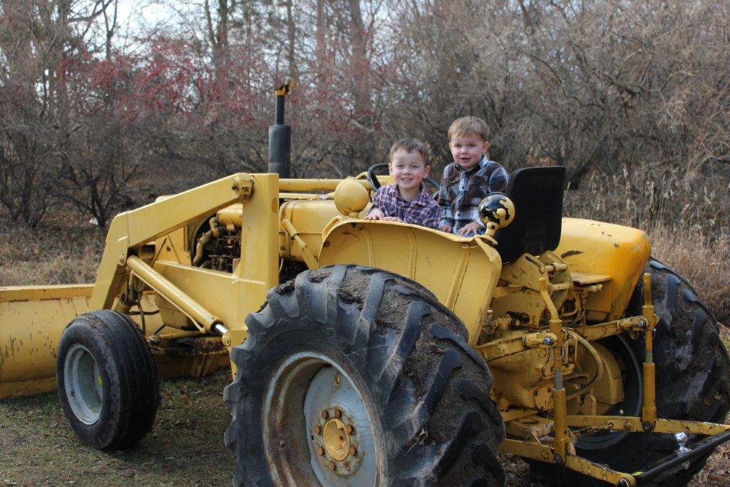

here is a picture without the backhoe on the machine.
kwalz View Drop Down
Joined: 24 Feb 2013
Location: Sebewaing, MI
Points: 16
Post Options Post Options   Thanks (0) Thanks(0)   Quote kwalz Quote  Post ReplyReply Direct Link To This Post Posted: 25 Feb 2013 at 7:24pm
That does look a little different than mine.  I did manage to find the serial number on mine, and found out it's a D14.
