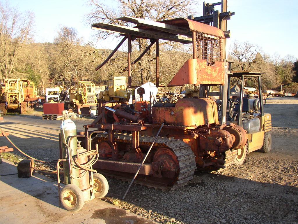

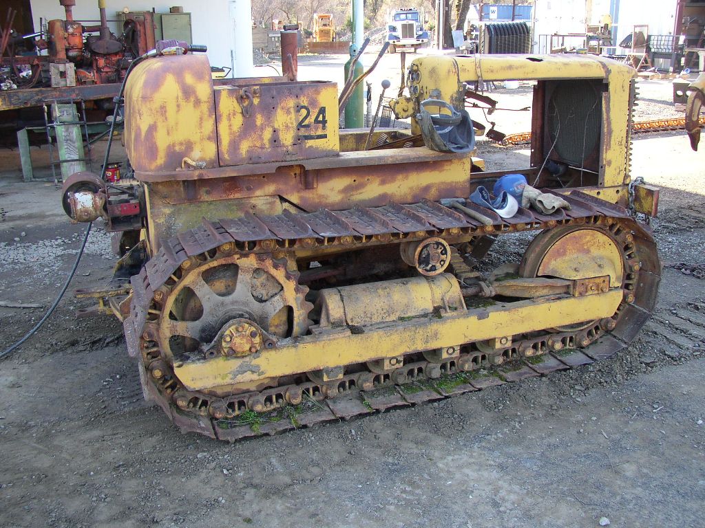

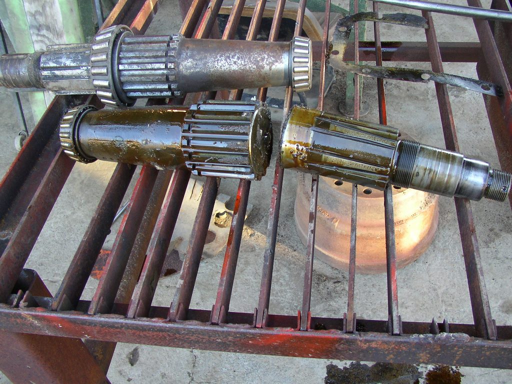

We have started restoration proceedings for this HD5 dozer. Yes it is nice to have the convenient tools to work with. We got the tractor running ok and found that the steering problem was a broken sprocket shaft. The yellow HD5 in the last picture is the DONOR tractor and I have already removed a good shaft and will start installation today. My brother has started painting and I'll post more as we go.

Looking at the break in the axle - I wonder how so much stress could be places on that point .
As it is inboard of the sprocket and the axle has a outboard bearing (link belt double row) at end of axle on truck frame.
 Seems the load would have had to come from the reduction gear system (bull gears).
Looks like some further investigation - then looks like you have that side of case open to find any other problems.

Yes, Coke your right it warranted more investigation. It was such a clean break that there weren't hardly any metal filings and it broke so abruptly that it couldn't be run to do more damage. I looked up in there with lights and mirrors and called it good and have begun reassembly

Mel: Nice yard full of equipment.  Keep us up to date on your progress.  Nice little 5 you have.  Good luck on the repairs.

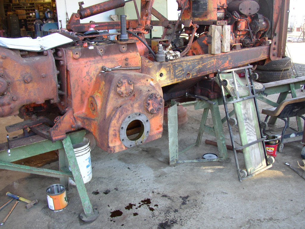

I was looking at where the blade attached on the little machine, and wondering if that could side strees the shaft enough to do that, right off the axle support, is the truck saddle mount damaged at all?

Be sure to check that top set of bearings on first reduction gear - every major failed rear I have seen that top bearing fails and breaks the rear case on outboard of that bearing
  As the blade hardware pushes against the rear housing - the outboard bearing by sprocket to truck frame is a 2 unit Link-Belt cone and cup bearing, then next inboard of the sprocket is large timken - the break is behind that bearing so flex of shaft it seems could not be stress from outboard of the sprocket without destroying both outboard bearings.

The shaft may have failed from fatigue failure due to its original machining. The failure looks like classic fatigue failure. If somehow the shaft was machined with a very sharp fillet where the bearing surface met the larger diameter toothed section it could have introduced fatigue failure. A few years ago I was asked to examine the output shafts of two angle drives that were used to turn paddles in large vats at a mine's mill. These were two new units identical to older units that had operated without problems for years. The units operated continuously and both failed about a month apart after 1-1/2 years use. They both failed by fatigue where the shaft diameter was turned down for the bearing. I took down all the data including the shaft rpm and plugged it into a formula to predict fatigue failure and it projected within days of when these shafts had failed. The only difference between the old angle drives and the new one's was the radius of the fillet where the shaft stepped down to a smaller diameter. It is also possible that the outer bearing was not in line with the other two and it introduced a slight bending action on the shaft or the outer bearing's mount could shift a little and apply a slight bending action on the shaft.

Your explanation of the bending action could be a possibility. The mounting area for the truck frame support - the area under machine where the Y section of truck frame fastened to the cast rear housing . On one HD5 BI had there were cracks by the inboard fastening area (the bolted on clamp for shaft)
 I had to re-shim the outboard bearing after replacing the axle and welding the rear casting.

Mel:  Wanted to ask a favor, can you post a close up picture of the support that are holding the 5 up in the air.   They look to be an excellent choice of support.  Channel iron and Ibeam - is that correct?
I would like to borrow the idea to use on support for my HD6 while I am working on it.

I like the the slatted table, looks like if you need to remove a few pieces of bar stock to let something hang down through you can
