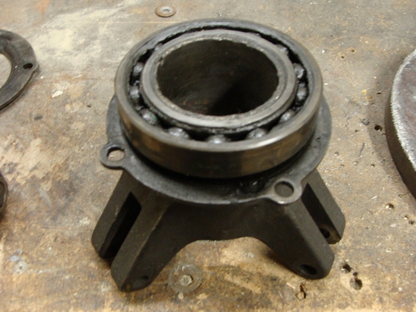

Yes, I have thought about trying to somehow repair the sleeve. the I.D. is really worn, so bad that the sleeve portion that had the bearing retaining snap ring was completely worn off. Now the bearing slips off the sleeve without the snap ring. I just don't know if there's a way to add a new sleeve portion to the 3 eared portion of the casting.

If I can't find a good used sleeve, I may have to have one made like Coke. Does anyone know what kind of clearance there is between the sleeve and the input shaft? Mine is excessively worn.
Also, I replaced the 3 cams inside the pressure plate with ones I got from Hector. The replacements didn't have grease fittings on them like my old ones did. Hopefully this won't be a problem as I don't use the machine very often.
