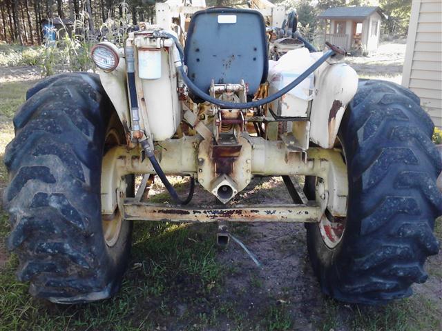

Hi,
I'm trying to learn a little bit about this tractor, which I believe to be an Industrial D15.  I have a lot of questions and would really appreciate any information concerning this tractor.
Is this an ID15?  What was the original color?  It looks like it has yellow primer, PO2, and then a coat of industrial yellow.  How rare are these and what is it worth?
There isn't a drawbar, 3-point and the PTO seems to be mostly covered up, would it be simply to convert this to a more farm ready tractor?

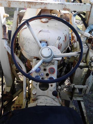

The engine has 2185 hours on it, is this a lot of hours?  The engine does turn over, but the batter or starter is too weak, so I tried to pull start it.  With the transmission in gear, the engine would not turn over, is there another clutch on it?  In the picture looking at the steering wheel, there are two levers on the left side, the large one says "forward" and "reverse" and then there is a smaller lever behind it, what are these for?

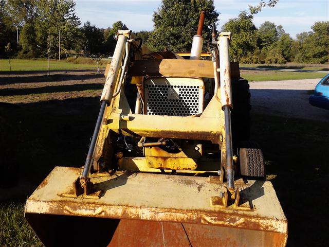

Any guess as to what company manufactured the loader?
In first picture, there are several gauges missing, any idea which ones are gone?
Lastly, given the following numbers from the tractor, could you please help me to identify it's year of manufacture and whether it uses the same engine as the D14 or the later, more powerful engine?
Engine: (right side) DC20U, (left side) 160-17803R
Transmission: AM4165, flange 6155110
Axle: AM4303-6
Thank you!

Post Options Post Options   Thanks (0) Thanks(0)   Quote steve(ill) Quote  Post ReplyReply Direct Link To This Post Posted: 18 Aug 2012 at 9:10pm
YEs, the heavy front grill and the heavy front axle show it is an industrial unit. I think they were called I-60 or I-600 depending on the age. Loader frame and no 3 point or PTO are other common signs. This would be a good tractor to purchase and rebuild. I think it is based on a D15 / motor/ rear end.

Post Options Post Options   Thanks (0) Thanks(0)   Quote JoeO(CMO) Quote  Post ReplyReply Direct Link To This Post Posted: 18 Aug 2012 at 9:24pm
that is a 615 has a 160 c i engine, missing tach, has a PTO

Post Options Post Options   Thanks (0) Thanks(0)   Quote DiyDave Quote  Post ReplyReply Direct Link To This Post Posted: 19 Aug 2012 at 12:54am
A few observations:  Smaller lever on left is pto clutch, forward is on. I believe the PTO is non standard, on this tractor, does not run at 540. Big lever on left is a F/R shuttle clutch, similar to the power director, which is a hi/lo clutch, on farm tractors.  I don't think the frame in back is set up for a hoe, maybe a concrete breaker(drop hammer).  2,000+ hours, if that's all aren't much, on a farm tractor, but the hours are harder, on industrials.  Sounds like the motor is locked up, try turning the front crank, with all levers in neutral, and the front pump disconnected.  Big hole in dash is for the original tach, smaller holes were for key switch, rubber starter button, perhaps other o.e.  switches.

Post Options Post Options   Thanks (0) Thanks(0)   Quote Calvin Schmidt Quote  Post ReplyReply Direct Link To This Post Posted: 19 Aug 2012 at 12:06pm
It is an I-60, I-600, or 615 which are all basicly the same and based on the D-15 series II tractor. The differances in the models mentioned was in the backhoe attachment. The loader is not the A-C factory loader for that tractor.

Post Options Post Options   Thanks (0) Thanks(0)   Quote RMD Quote  Post ReplyReply Direct Link To This Post Posted: 23 Aug 2012 at 8:43am
Loader was most likely made by Henry Manufacturing Co. which was eventually acquired by AC.

Post Options Post Options   Thanks (0) Thanks(0)   Quote orangeman Quote  Post ReplyReply Direct Link To This Post Posted: 23 Aug 2012 at 3:16pm
It appears to be an early 615 Industrial with Shuttle Clutch.  Loader looks odd particularly the vertical brace support near the gas tank.
Most 615's I have seen utilize the loader boom as the hydraulic reservoir.  Looking closely at  your pics you can see the hydraulic reservoir is located on the operators left hand station which complicates the seating arrangement.
615 also came with optional tire and rim sizes.   See depth of rim on the 615 that is in the color photos.
Also seat is not original.
