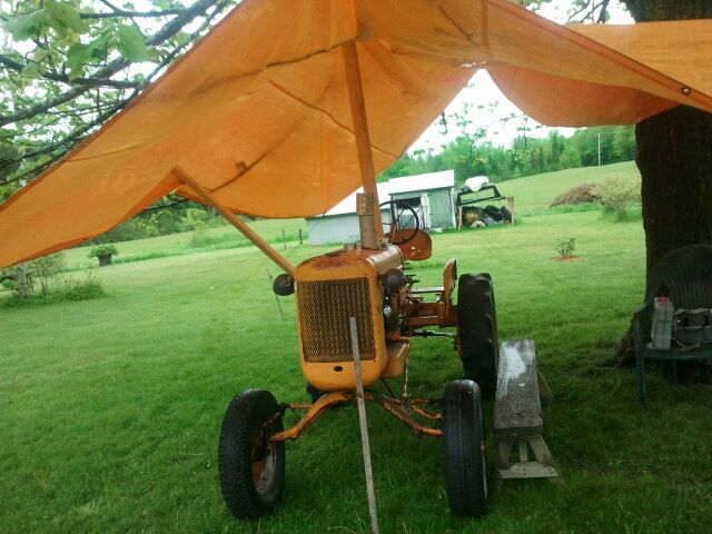

Hi all! Im new to the Forum. I was at a Antique Tractor show today and was a little disappointed I couldn't bring my ol model b out. The tractor is a 1946 Model B, as far as I know not a "Special" model how ever has what I think is a WC seat on it. Its not a bench, its a spring. (See pictures below)
uploads/7440/Modelb.jpg

WELCOME to the FORUM !! Your seat is an "aftermarket" seat. possible a Monroe.
The tire size that you need ia 9.5 X 24 and can be purchased from tire shops such as Miller tire, who advertise on this site. You tractor looks very good. It must have been very well taken care of. Bob
