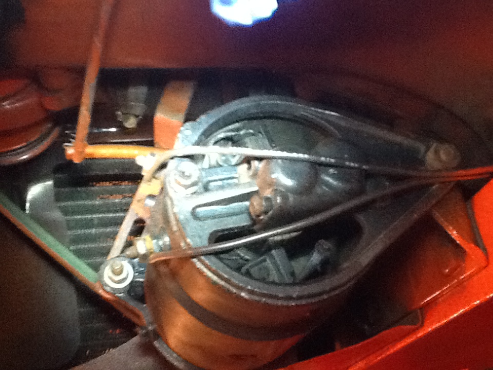

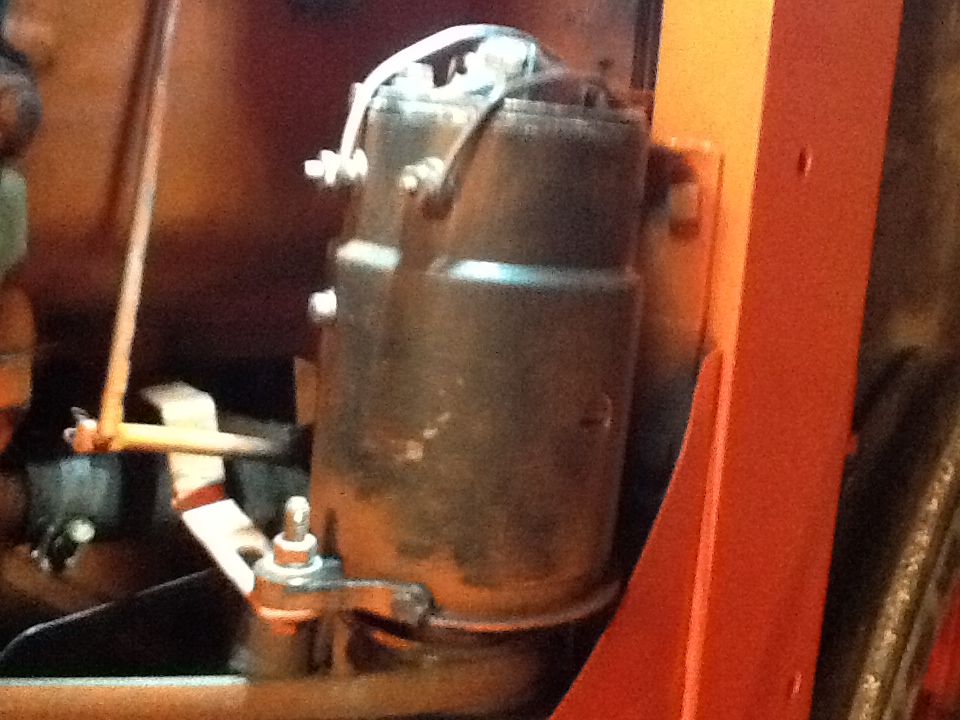

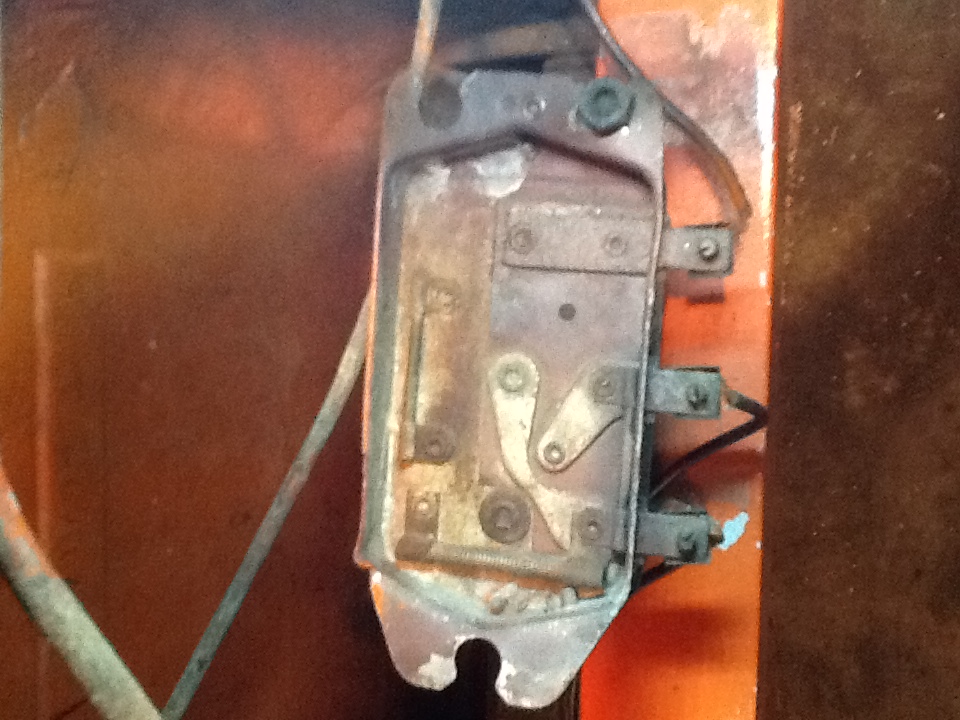

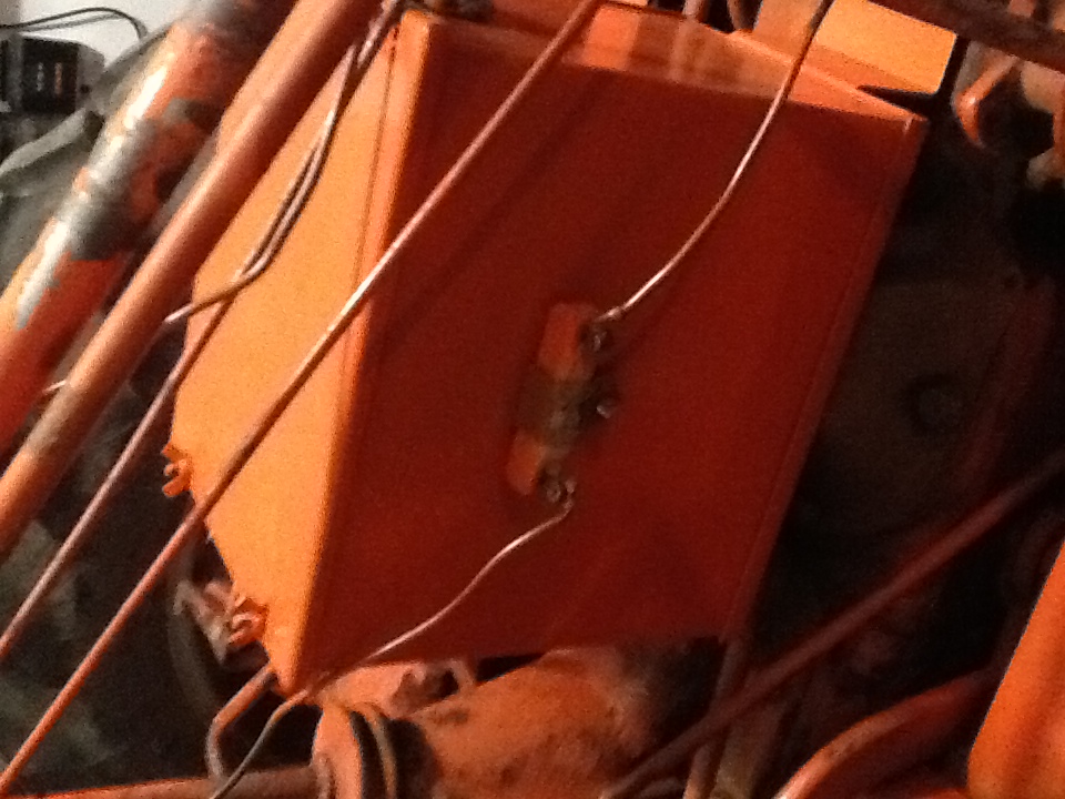

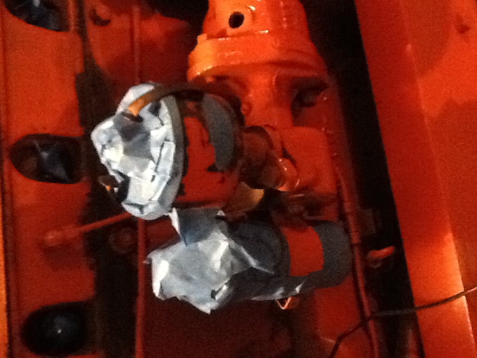

Ok guys here are a few pics of what I have on my WD, yes they have overspray on them cause I am in the middle of painting it!
The Generator is only a two brush, and you probably can't see the 12 V stamped on it though.
The voltage regulator has no marks at all.
The resistor on the battery box is I assume to lower voltage but for what reason I have no idea.
I also included a pic of the distributor and coil. I assume the starter is good for either 12 or 6 volt cause it still works.
So maybe this will clear up some speculation. I appreciate everyones advice, any ideas on what I can eliminate or change to get this battery to charge is much appreciated.
Coke-in-MN View Drop Down
Location: Afton MN
Points: 42086
Post Options Post Options   Thanks (0) Thanks(0)   Quote Coke-in-MN Quote  Post ReplyReply Direct Link To This Post Posted: 30 Apr 2012 at 8:14pm
Looks like it is a 12V gen from the step down in the field frame.
Try this site to find the info on checking the system and checking the wiring

Do you know of any reason I can't get rid of that resistor and go with a 12Volt coil? The tractor has no lights. I'm going to buy a set after the paint job is done.
Points: 12043
Post Options Post Options   Thanks (0) Thanks(0)   Quote Steve in NJ Quote  Post ReplyReply Direct Link To This Post Posted: 30 Apr 2012 at 9:05pm
I'm getting in on this late but, if the Gennie says 12V stamped into it, its probably a 12V unit. Also, a lot of your 12V versions have the step down chassis as Coke mentioned. A good thing to do is loose that resistor, and install a 3.0 ohm internal resisted coil. This will eliminate missing, hard starting etc that comes with those external ballast resistors. You need to establish 2.7-3.3 ohms of resistance in the Ignition circuit running 12V's with a 4 cylinder engine. The 3.0 ohm unit sticks you right dead center. What I would do is have a local rebuilder check the operation and output of the Generator. Determine whether or not the Gennie is working properly and its total amperage output is. Once that is established, have your rebuilder mate a new VR to the Generator via max output recorded. Now you have the two units that will work together as a team. Make sure your wiring and connections are good, and wire either PG or NG. After you decide which way you want to run the system, polarize the system. You should be good to go from there!  HTH
Steve@B&B
Geppy View Drop Down
Joined: 29 Apr 2012
Location: Indiana
Points: 24
Post Options Post Options   Thanks (0) Thanks(0)   Quote Geppy Quote  Post ReplyReply Direct Link To This Post Posted: 30 Apr 2012 at 9:09pm
Good advice, I have a local auto electric shop here in Churubusco that I will have take a look. So your saying I can find a 12V coil with an internal resistor correct? I know with my other tractor I had to buy a new starter and the guys at the shop told me to bring the generator in and get it checked and have a regulator matched to it. I will do this for sure. Thanks again.
Edited by Geppy - 30 Apr 2012 at 9:10pm
Points: 12043
Post Options Post Options   Thanks (0) Thanks(0)   Quote Steve in NJ Quote  Post ReplyReply Direct Link To This Post Posted: 30 Apr 2012 at 9:12pm
If you have problems finding a coil, we have lots of em' in stock...
Steve@B&B
Joined: 29 Apr 2012
Location: Indiana
Points: 24
Post Options Post Options   Thanks (0) Thanks(0)   Quote Geppy Quote  Post ReplyReply Direct Link To This Post Posted: 30 Apr 2012 at 9:12pm
One more thing, does any of this affect the distributor?
jccleav View Drop Down
Joined: 11 May 2011
Location: Indianola IA
Points: 211
Post Options Post Options   Thanks (0) Thanks(0)   Quote jccleav Quote  Post ReplyReply Direct Link To This Post Posted: 30 Apr 2012 at 10:18pm
No. The difference in coil resistance takes care of that.
