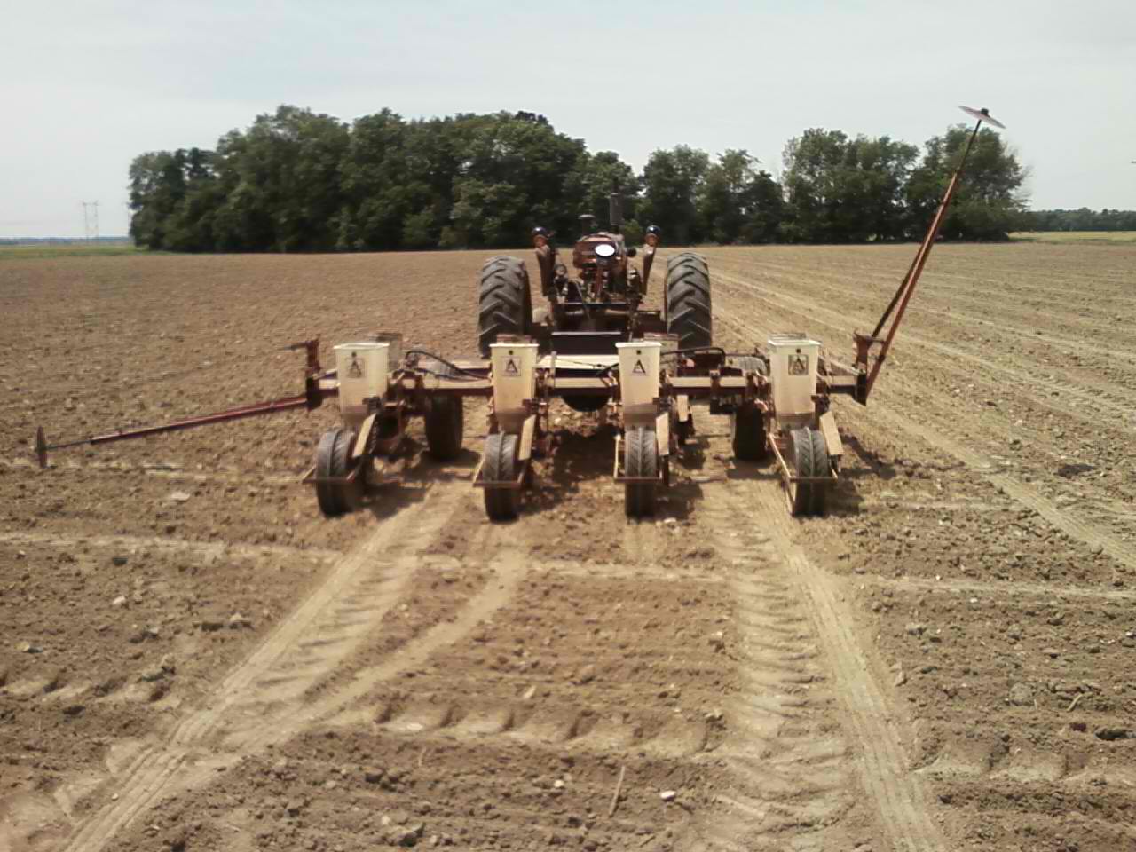

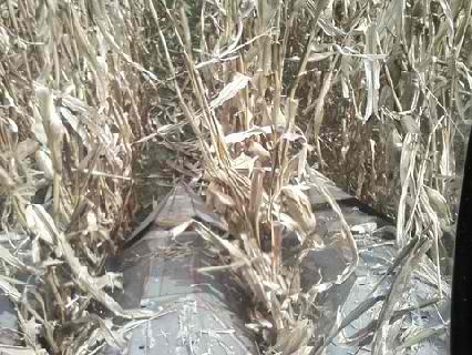

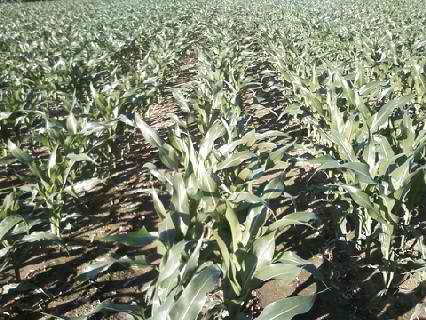

I will try to put pictures on! I have been thinking about twins for yrs. came up with the idea , to use a 600 frame planter and 8 units 7 inches apart  on 38's  I know plants aren't  off set like some planters can do. but, they are still spaced farther  apart than in a single 38 I dropped 30 K from this one . on twins and 30 K on our single row , all other factors  were the same. the twins yielded 184 bu. the singles 177 bu. and Yes, you can tell by the pics. I am cheap. all corn will be on twins this yr. with fresh paint . Bill tia Smile
