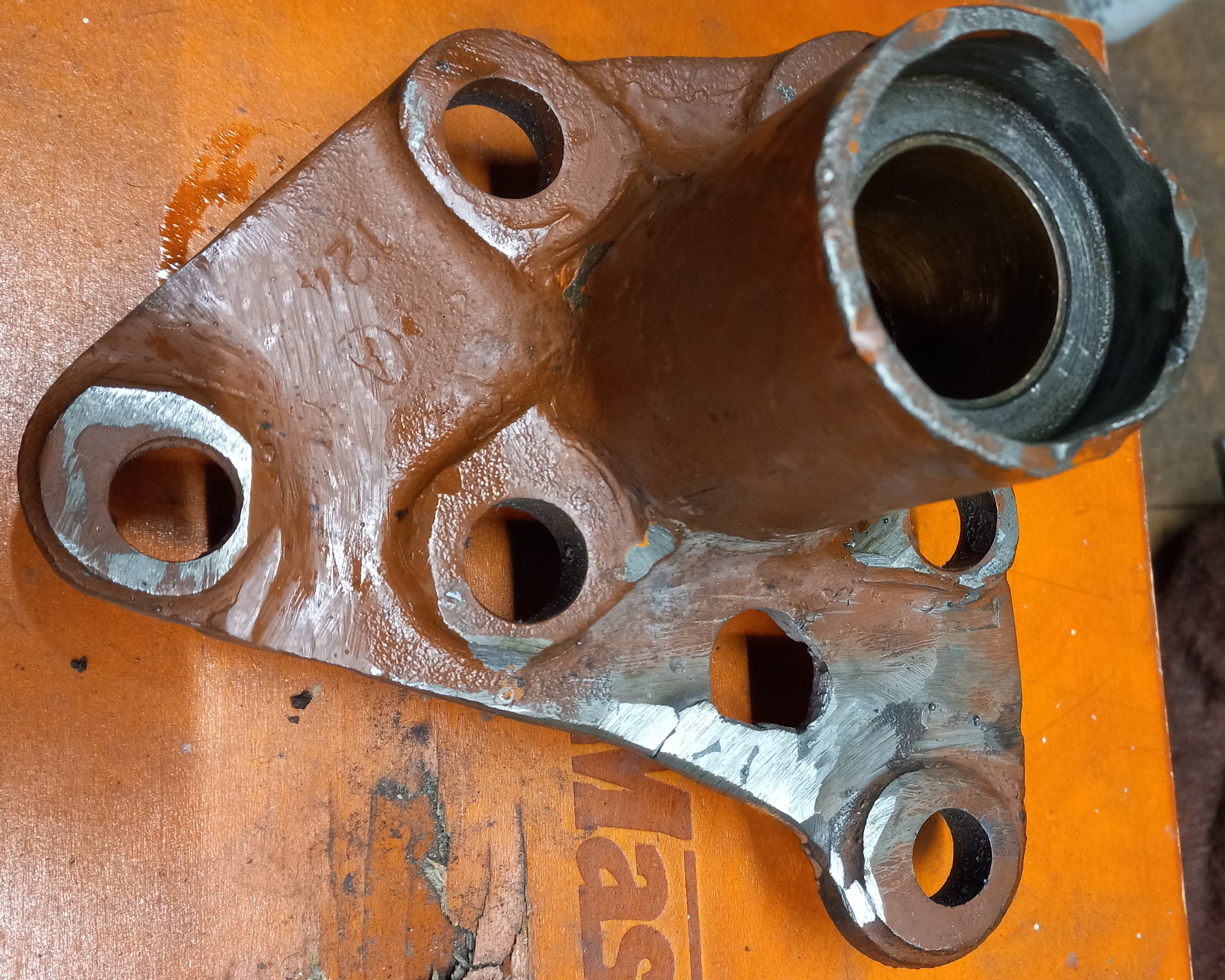

Thanks, I got it apart. In taking it apart, I found that the gear oil had at some point had gotten water in it. It had turned into a grayish/brown goo. I have all that cleaned out now.
 Now onto the repairs. the mounting tabs have broke off. I am welding them back on. The oval adjustment hole for the eccentric rivet has a chunk from the side is missing. I have gotten some steel to fill the gap.
The side cover gasket was missing, I have an O-ring that may fit. The lock ring for the upper adjusting sleeve is also missing. I am attempting to make one.
The side cover looks like someone had used clear silicone to try to seal the side cover. I don't think it worked.
I will post some pictures later to night.

here is the side cover before working on it.
Points: 90751
Post Options Post Options   Thanks (0) Thanks(0)   Quote steve(ill) Quote  Post ReplyReply Direct Link To This Post Posted: 18 Mar 2024 at 8:25pm
wonder how they got broke ?  tractor rolled over ?
bevel good and preheat 250 degrees with torch or propane/torch ...also burns off any oil residue . you should be OK.

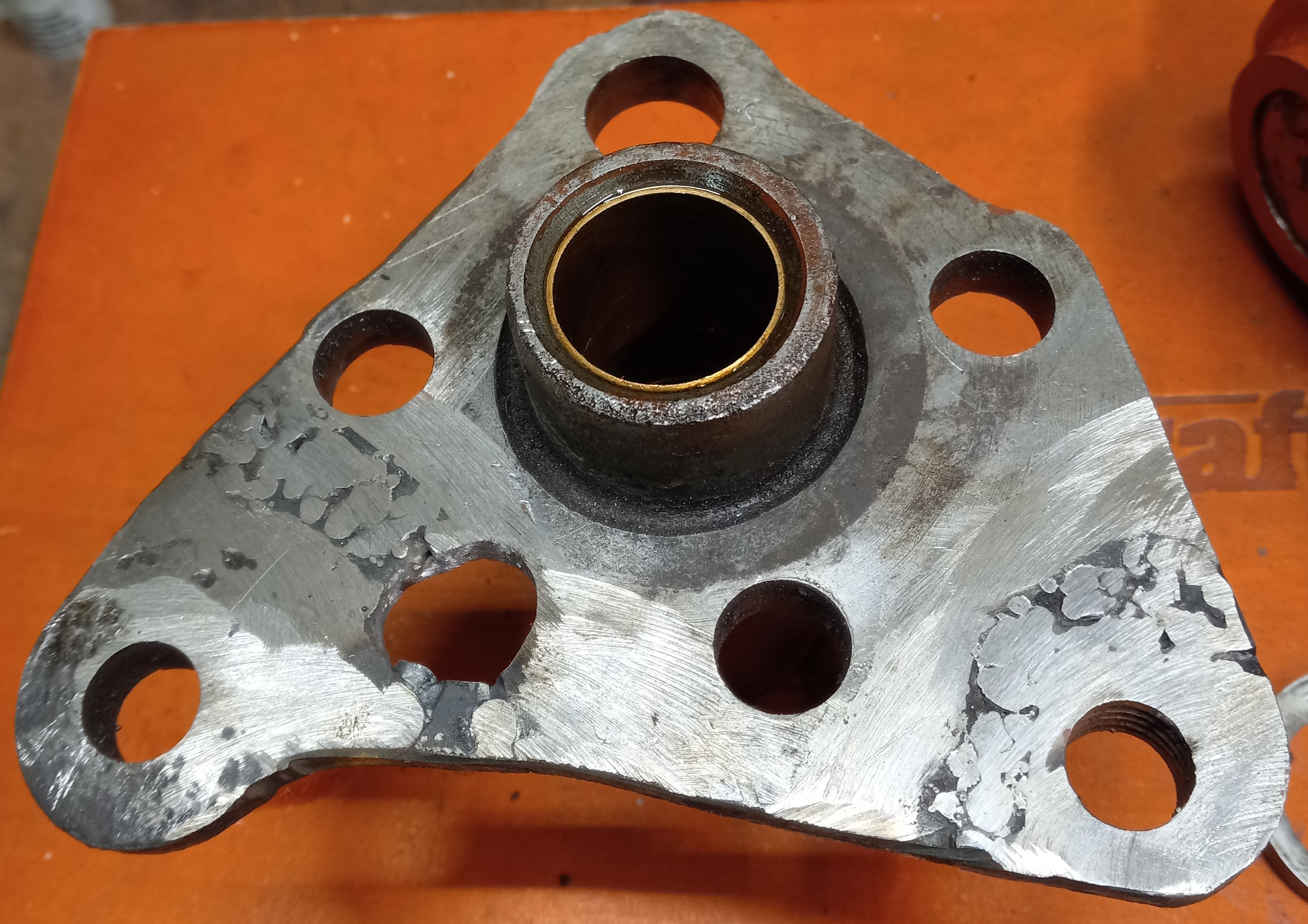

Here is a picture of the inside after repair.

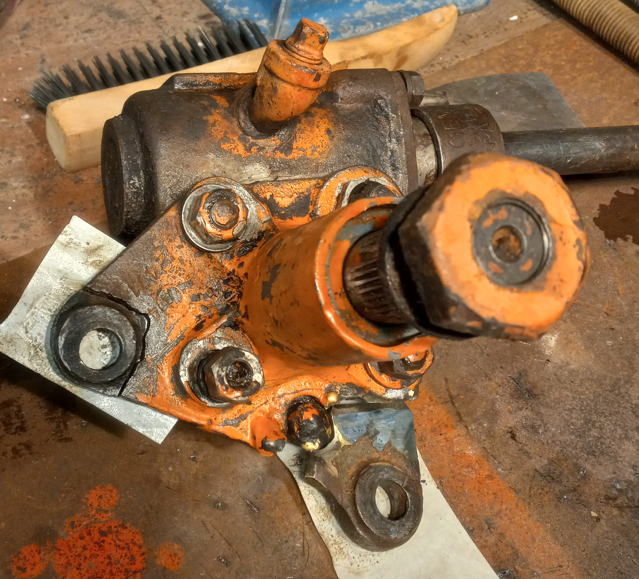

Post Options Post Options   Thanks (0) Thanks(0)   Quote DSMhoneyyard&farm Quote  Post ReplyReply Direct Link To This Post Posted: 18 Mar 2024 at 8:36pm

Post Options Post Options   Thanks (0) Thanks(0)   Quote DSMhoneyyard&farm Quote  Post ReplyReply Direct Link To This Post Posted: 18 Mar 2024 at 8:38pm

Post Options Post Options   Thanks (0) Thanks(0)   Quote DSMhoneyyard&farm Quote  Post ReplyReply Direct Link To This Post Posted: 18 Mar 2024 at 8:41pm
Does anyone have a good image of what the hole for the eccentric rivet should be shaped like?
