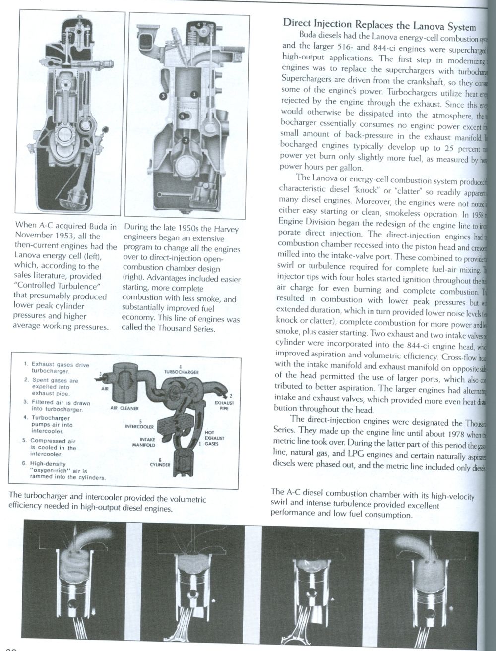

This is some of the information I was able to put together from my project:
http://home.comcast.net/~old_allis/Lanova_System.html
TomMN View Drop Down
Location: Elbow Lake, MN
Points: 858
Post Options Post Options   Thanks (0) Thanks(0)   Quote TomMN Quote  Post ReplyReply Direct Link To This Post Posted: 06 Dec 2011 at 9:56pm
A couple of pictures help the description:
