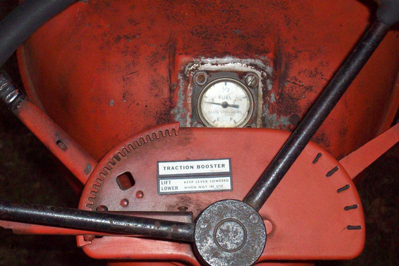

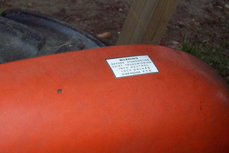

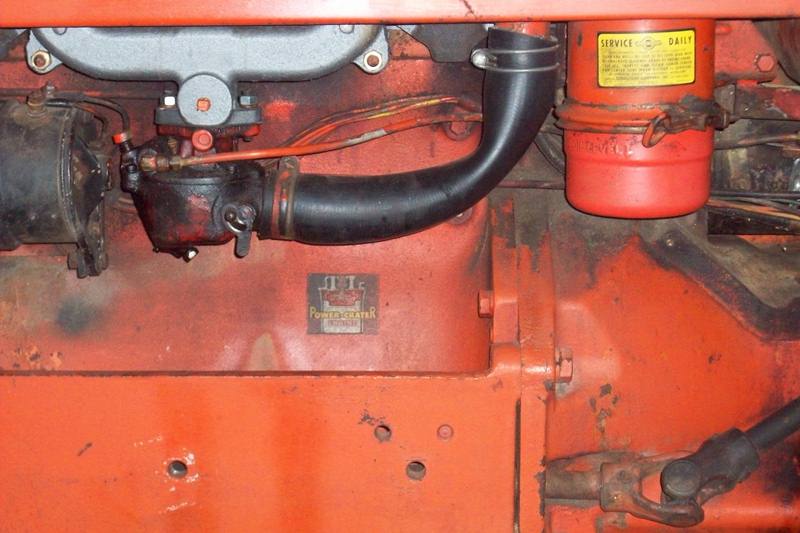

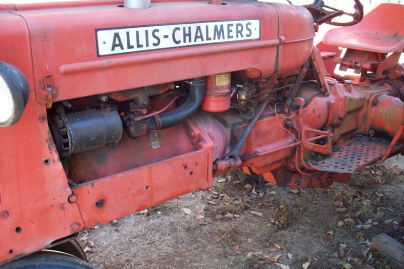

I like your paint job, I love the 57 decal designs.  These pic show some decals you asked about.  Some parts are not original,  the hood is wrong, this is really a 57...
If I get it inside I can shoot better pics...

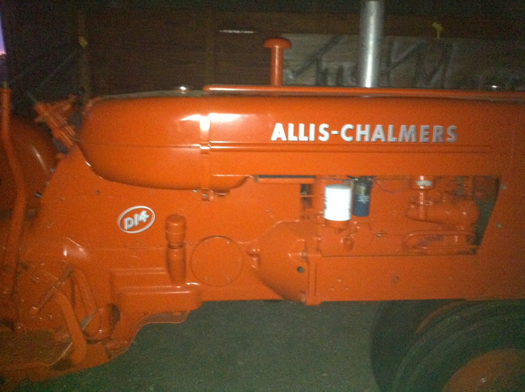

Post Options Post Options   Thanks (0) Thanks(0)   Quote Rick of HopeIN Quote  Post ReplyReply Direct Link To This Post Posted: 15 Nov 2011 at 6:39pm
another

11 - goes on throttle quadrant

Picture of Power Crater Decal on '60 D14 I did for neighbor.

I think those decals should actually be on the traction booster and lift-lower levers.
Dave (Mid-MI) View Drop Down
Location: Hemlock, MI
Points: 566
Post Options Post Options   Thanks (0) Thanks(0)   Quote Dave (Mid-MI) Quote  Post ReplyReply Direct Link To This Post Posted: 20 Nov 2011 at 12:50pm
According to sales literature from 1959, the lift-lower and traction booster decals go on the levers like Blake said. They look to be about 1/2" away from the rubber tips on the levers. The same brochure shows the PTO warning decal centered on the quadrant above the steering wheel shaft. Couldn't find any pics of decals in earlier literature. Seems like many times the early brochures are pics of prototype tractors which don't necessarily have all the decals in place.
