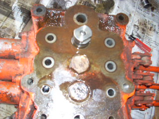

OK the protrusion towards the top center of pic is a valve in under the TB valve assembly. The ball does not sit tight in the seat which is visible. Of course I took it apart and put it back together. But it doesn't seem correct not seating but then again maybe when oil pressure is applied it does seat. Anyways all valves for the remotes slide nicely and the detents work well. I'm thinking tomorrow putting it back on the tractor, hooking it up and pressure testing everything per service manual.

Dana, the ball is supposed to sit toward the top of the housing, you have it in backward.  The ball seats against the copper washer under the the seat, then the spring, then the housing screws down holding it all together.    In the service manual its call a "ball check", and its not real clear how it works.   A parts breakdown will help, you can go on AGCOs web site and look at a D19 parts book.  Unless the orings are real hard your probably ok reusing them, but if I had new one on hand Id replace them.   Good luck!!!!!

Thanks Skip. When I unscrew that valve in the picture above I remove that visible top, then theres a ball, then a spring, then another ball which sits in a 1 inch long dohicky that looks just like a golf T. There is no copper washer. I looked at Agco's site and apparently I have to download some program so I can see a pic so thats what I'll do. I found a gauge so I can pressure test; as you said maybe the problem is the pump. My lift arms will not budge no matter what I have done with the lift arm lever even with my backhow pushing down on them with who knows how many pounds!!

Unhook the cylinders, the arms should come down.  If they dont then they are rusted tight, if the arms come down, then the cylinders are frozen, will have to take them off and take apart and clean up.  If in a previous life the tractor spread fertilizer or pulled an anhydrous applicator you can get corrosion in the and freeze them up.     Your correct, two balls, not one!!!    Yea, I had to download the program too, it does work.  You have to unscrew the T dohicky, it holds the copper washer in place..  Good luck.  HTH
