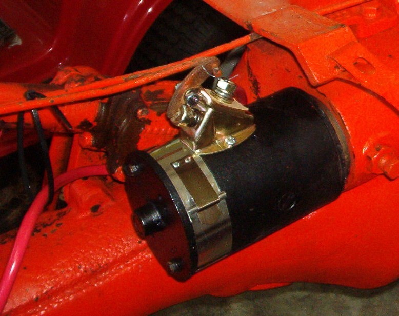

Post Options Post Options   Thanks (0) Thanks(0)   Quote Bee Quote  Post ReplyReply Direct Link To This Post Posted: 23 Feb 2011 at 2:49am
Bob, North Carolina
1949 B

Post Options Post Options   Thanks (0) Thanks(0)   Quote Denis in MI Quote  Post ReplyReply Direct Link To This Post Posted: 23 Feb 2011 at 8:28am
I never saw a switch on top like that

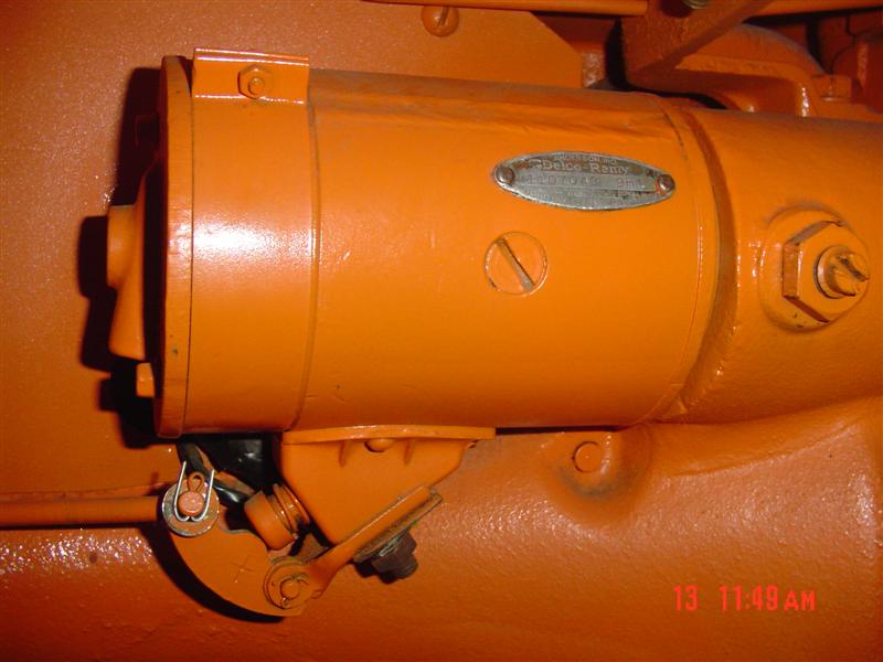

Post Options Post Options   Thanks (0) Thanks(0)   Quote Jacob (WI,ND) Quote  Post ReplyReply Direct Link To This Post Posted: 23 Feb 2011 at 8:56pm
Here is a pic of Lil' Allis's push type Delco Remy starter switch area:
Don't know if this helps any, good luck Jim, we all have those days.....
