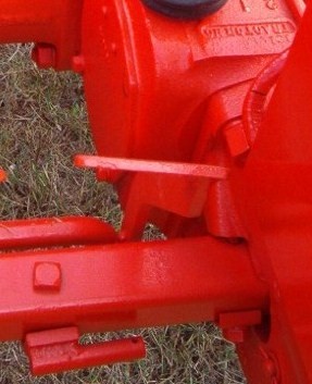

Post Options Post Options   Thanks (0) Thanks(0)   Quote Bee Quote  Post ReplyReply Direct Link To This Post Posted: 13 Jan 2011 at 9:21am
Bolt in bottom right of pic...
Bob, North Carolina
1949 B
