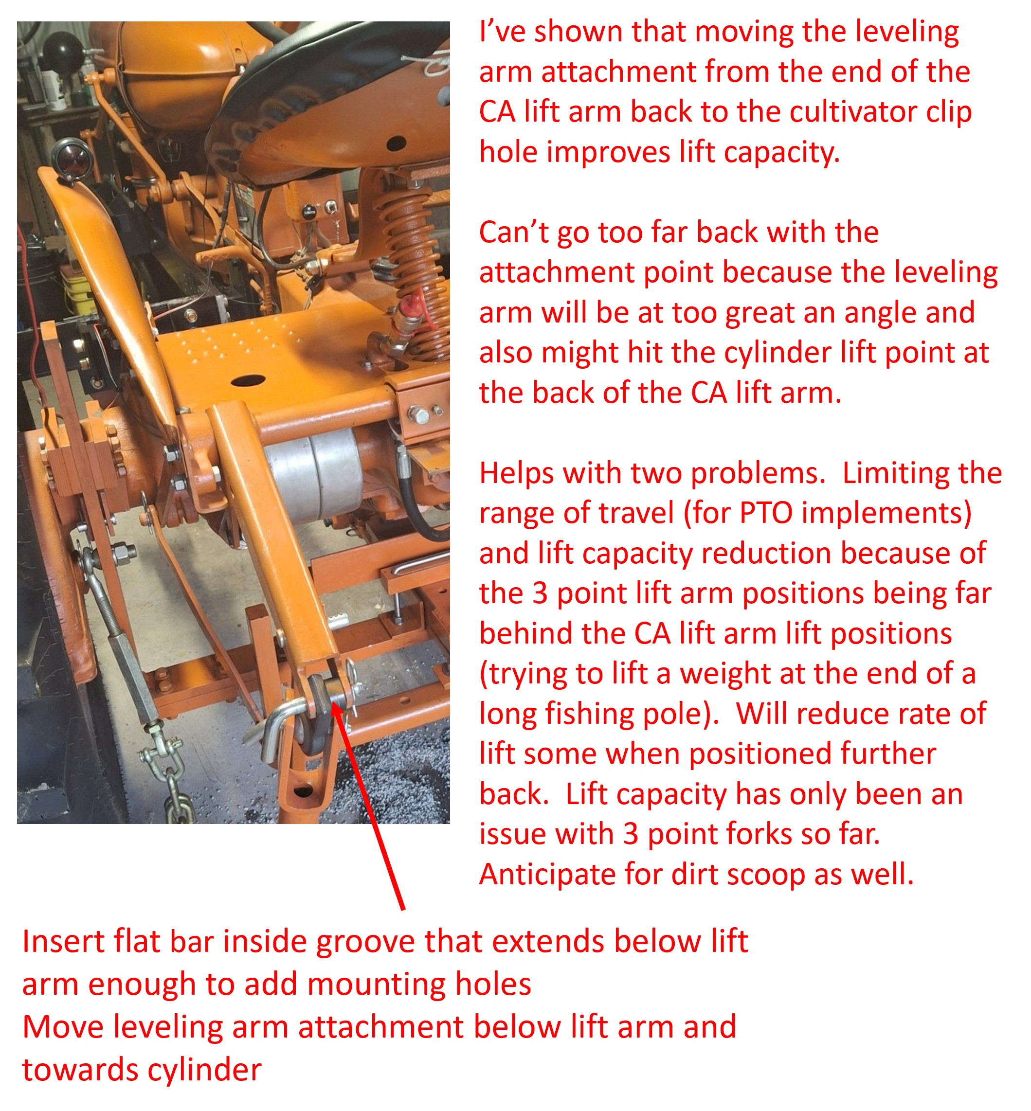

Those with an add on 3 point hitch may find that attaching the leveling arms at the cultivator pin hole 3.25 inches in from the end of the ca lift arms results in improved lift capacity, depending on geometry (or not, since the distance to the load is shorter regardless). In my case, fairly significant. Those holes better align with the lift arm attachment position also. I needed a short extender for clearance reasons. I used a weld on lift arm ball with a 5/8 hole added (TSC). I used a bent one so that I can adjust it for greater side to side play for the lower lift arms. Flip it right or left as needed. I also made a spacer to keep it in position left side or right as needed. Of course lift height is reduced a little.

I've decided to experiment with flat bar inserts inside the CA lift arms.  I can then add multiple connection point holes for the 3 point leveling arms along it's bottom length.  I don't want to mod the tractor itself.  An insert that uses existing holes in the CA lift arms allows me  multiple force vs lift height tradeoff options for lift capacity.  Superficially (thought experiment), this seems like the best most flexible option so far.  Hopefully, this doesn't allow more force than the CA lift arm welds can handle.

i wish you had a picture to go along with this to visualize the modifcation..

Post Options Post Options   Thanks (0) Thanks(0)   Quote dfwallis Quote  Post ReplyReply Direct Link To This Post Posted: 02 Jul 2026 at 8:41am
1952 CA13092, CA Pickup Plow, CA Cultivator, CA Two Row Planter, Dunham-Lehr GC78 Disc, Grader Blade, 3pt Fm180 Finish Mower

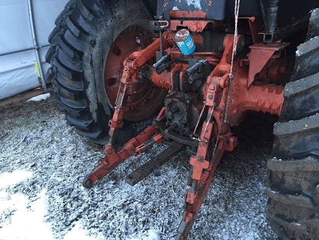

I do see a lot of tractors where the upper attachments of the leveling arms are very far back from the attachment to the lower lift arms (the upper lift arms are very short in many cases).  This makes the leveling arms have a very steep angle toward the tractor. I wonder if there's an "ideal" angle.
Edited by dfwallis - 02 Jul 2026 at 9:23am
Points: 93341
Post Options Post Options   Thanks (0) Thanks(0)   Quote steve(ill) Quote  Post ReplyReply Direct Link To This Post Posted: 02 Jul 2026 at 9:49am
the PERFECT angle from a design force point of view would be 90 degrees... Of course that is not always possible.. Given a big enough cylinder and pressure, you can change the angle to anything you want.  REAL STEEP angles use a lot of wasted force to lift the load.. The upper arms being short , have the pivot pin only travel a short distance compared to  the pin end of the lower 3 point arm... Your right, its a "give and take" to get what you want.. Lots of lift (distance), or lots of force (load)... or a compromise inbetween.

I've done a brief image survey and it seems like the majority of 3 point leveling arm connections across brands are at about a 30-40 degree angle like shown above, when in the down position.  That doesn'tseem optimal.
