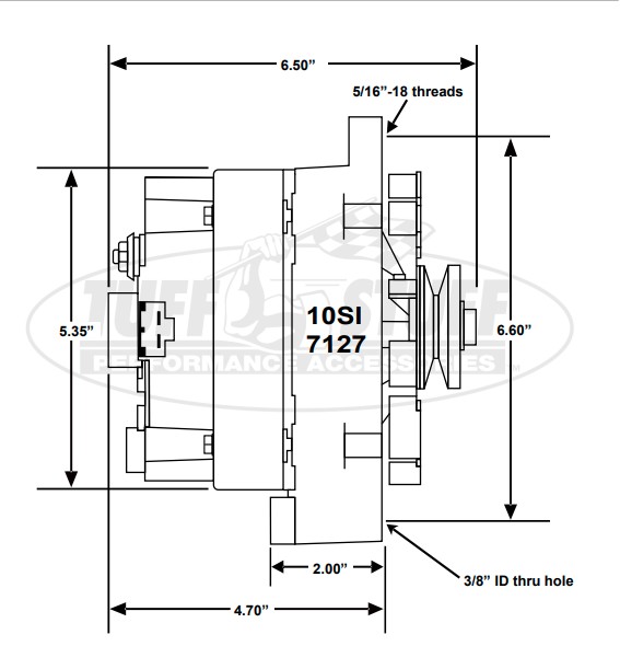

Post Options Post Options   Thanks (0) Thanks(0)   Quote steve(ill) Quote  Post ReplyReply Direct Link To This Post Posted: 26 Jun 2026 at 8:40pm
here are some dimensions if you want to see how it will fit...
