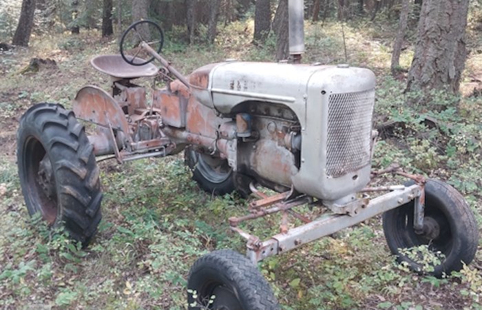

A 'Friend' of mine showed up last Friday with this Model C on his trailer and refused to leave without unloading it Tongue
The engine is stuck,  the tires are poor but they hold air, it rolls freely and the brakes seem to work, and the transmission shifts into all gears. The radiator is either brand new or has been rebuilt, it has a new temperature gauge and a new oil pressure gauge. It also has a 1-3/8" PTO shaft.

My kinda friend!!

Looks like it’s been in a sand storm
The color doesn't show well in the photo but it was painted silver Dead
He got this tractor thinking it would be a good parts machine for the derelict Model C I have been tinkering with, trouble is, this one looks to be in MUCH better condition Big smile My Grandson is already making plans for it Wink

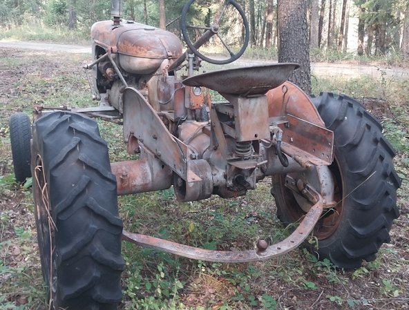

The seat suspension on this tractor caught my attention, it looks similar but not quite the same as our MM ZB. Was it a vendor item available as an option, or was it sold as an aftermarket item? Looking through pictures of other Allis Cs I didn't see another one like it.
