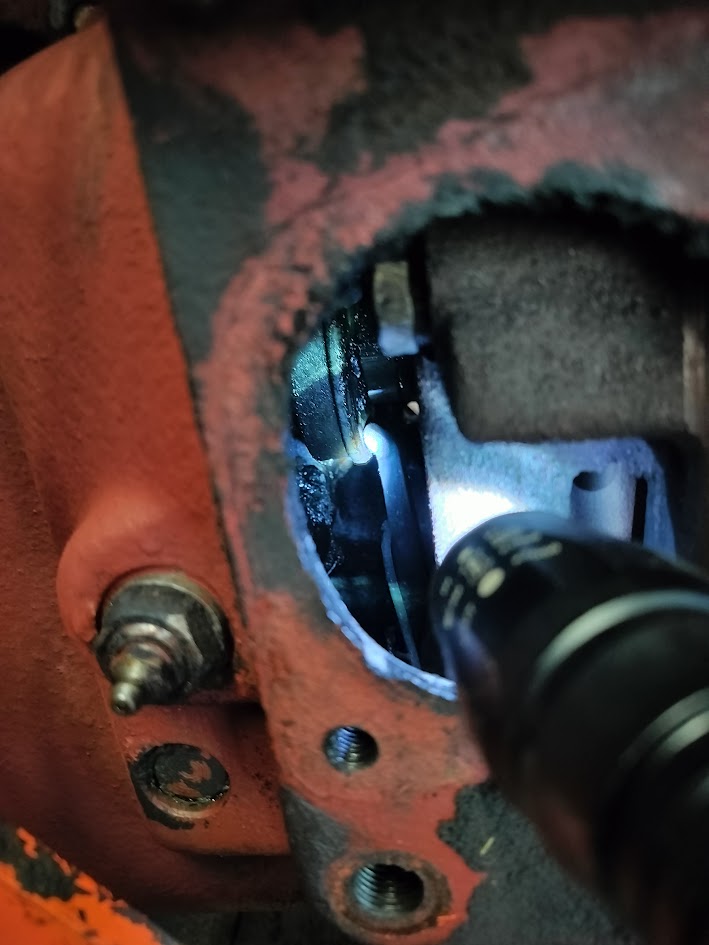

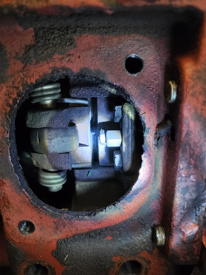

Hi guys, I have a new to me 1976 5040.  6 speed with the dual clutch.  The clutch has been slipping badly (known problem when I picked it up)  I have the inspection plate removed after taking the loader frame off.
Anything in high range is completely useless.   When I take the inspection plate off the first thing I notice is alot of grease.  Second thing is the clutch fingers are touching the throw out bearing (I think there should be a gap).    Does anybody have access to the clutch specs.  How to adjust?  Basically pages from the service manual.

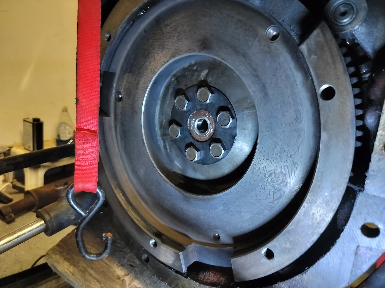

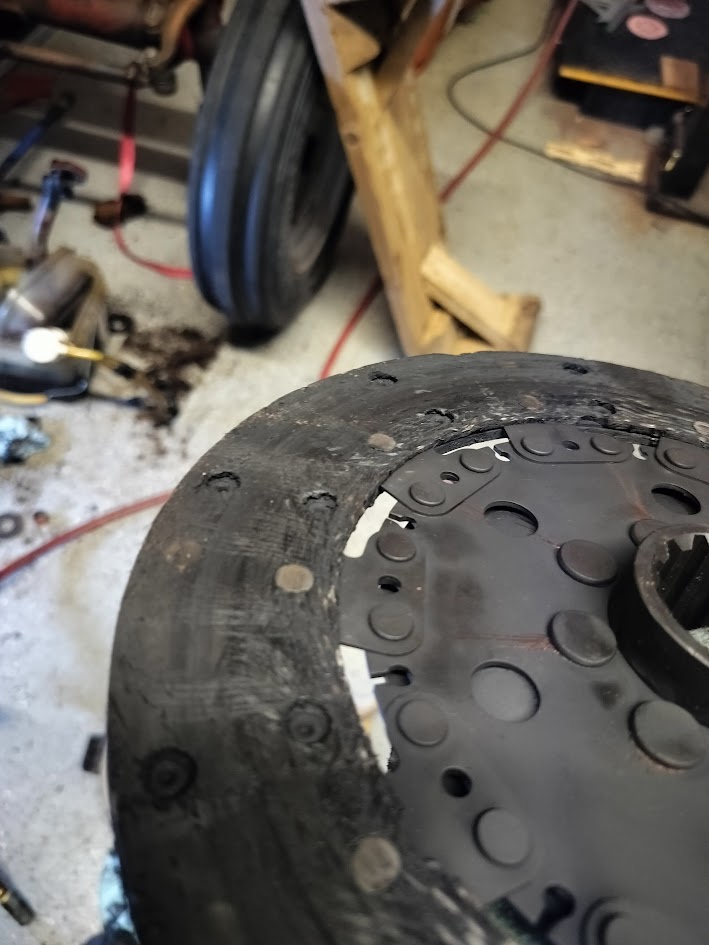

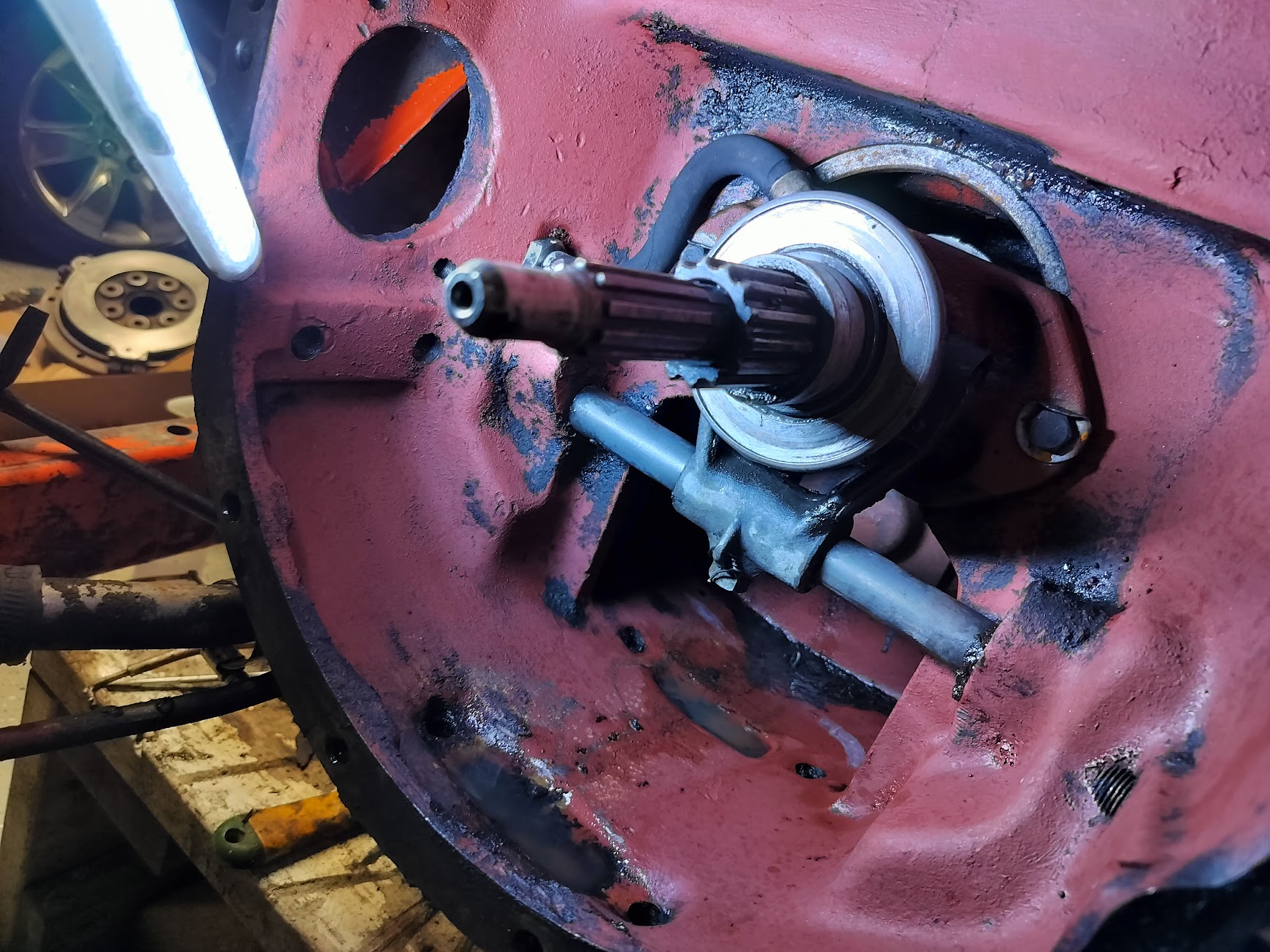

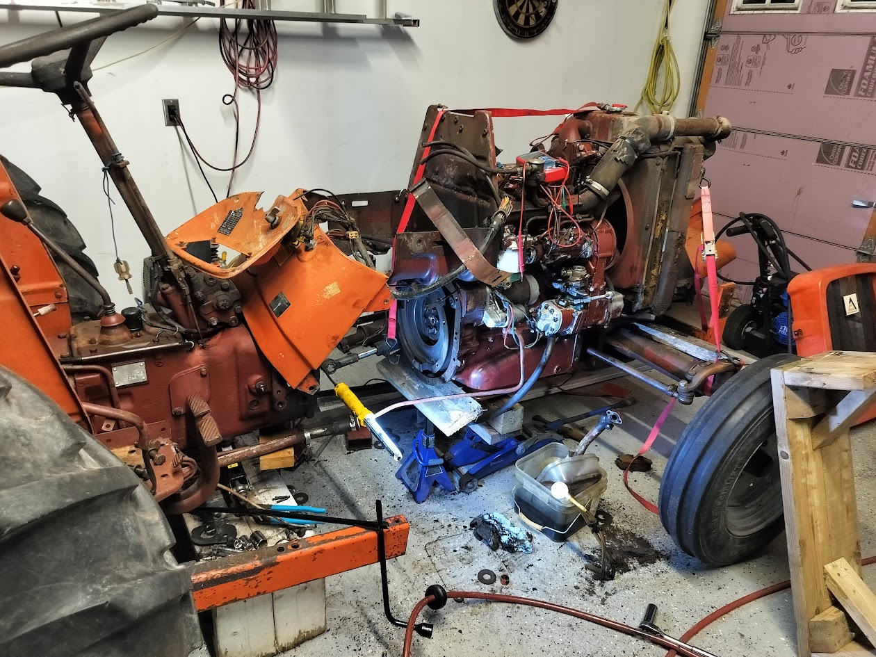

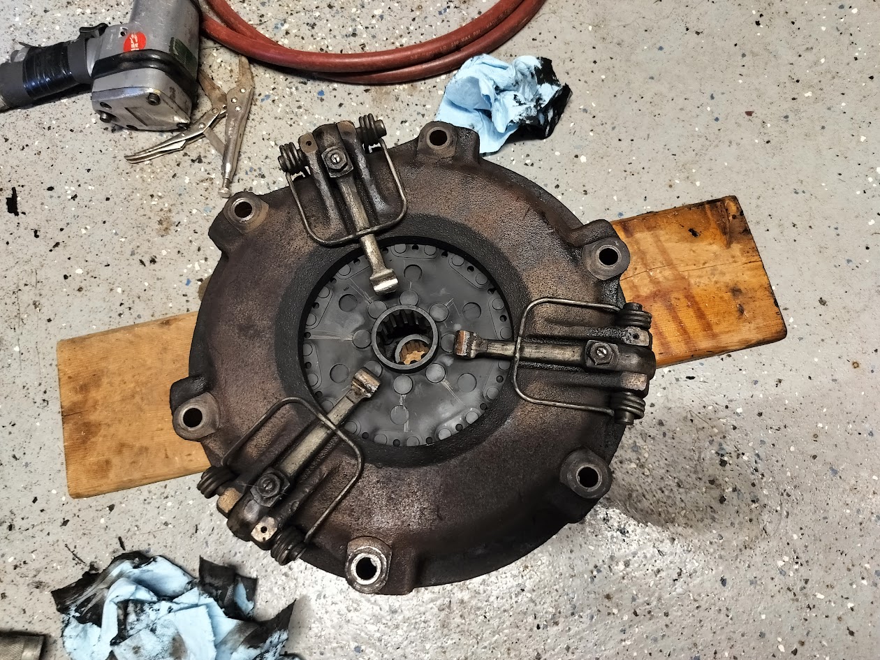

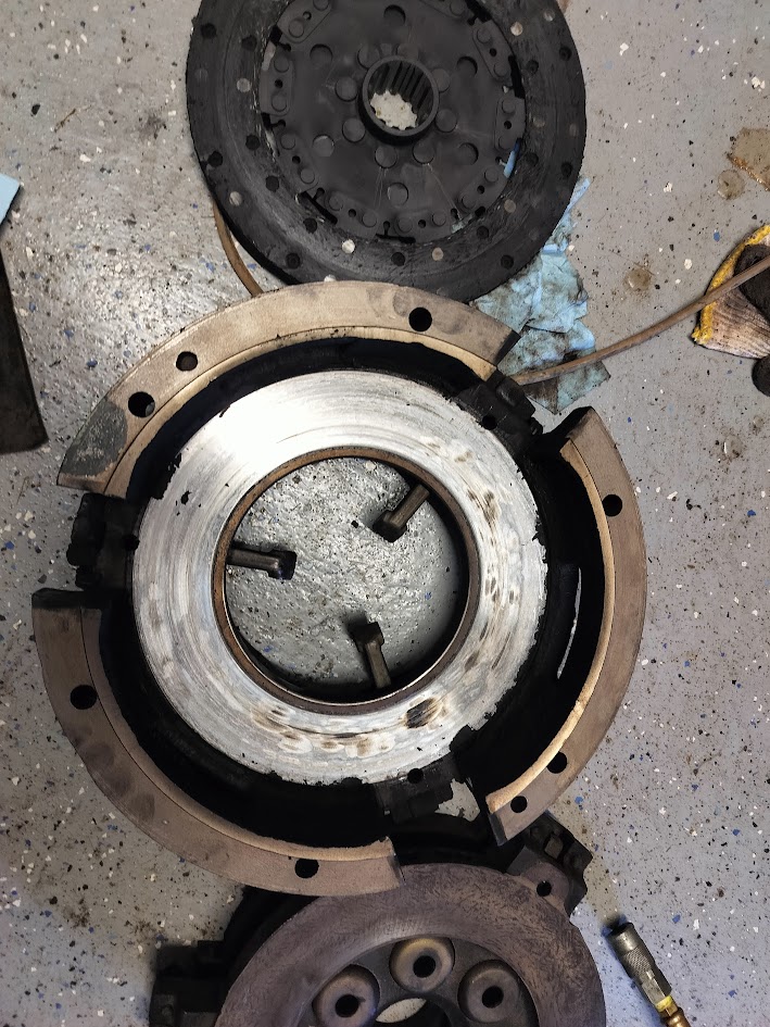

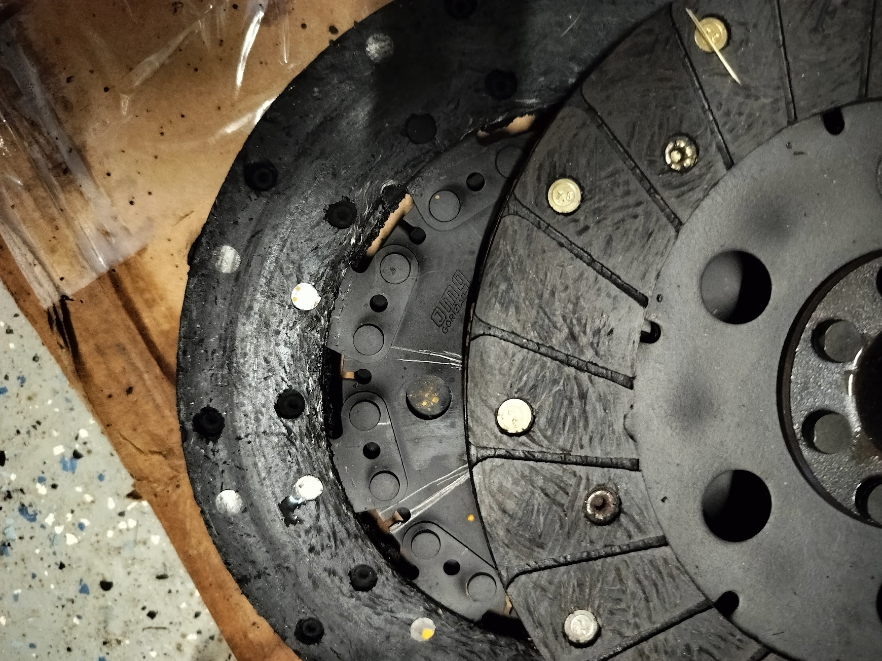

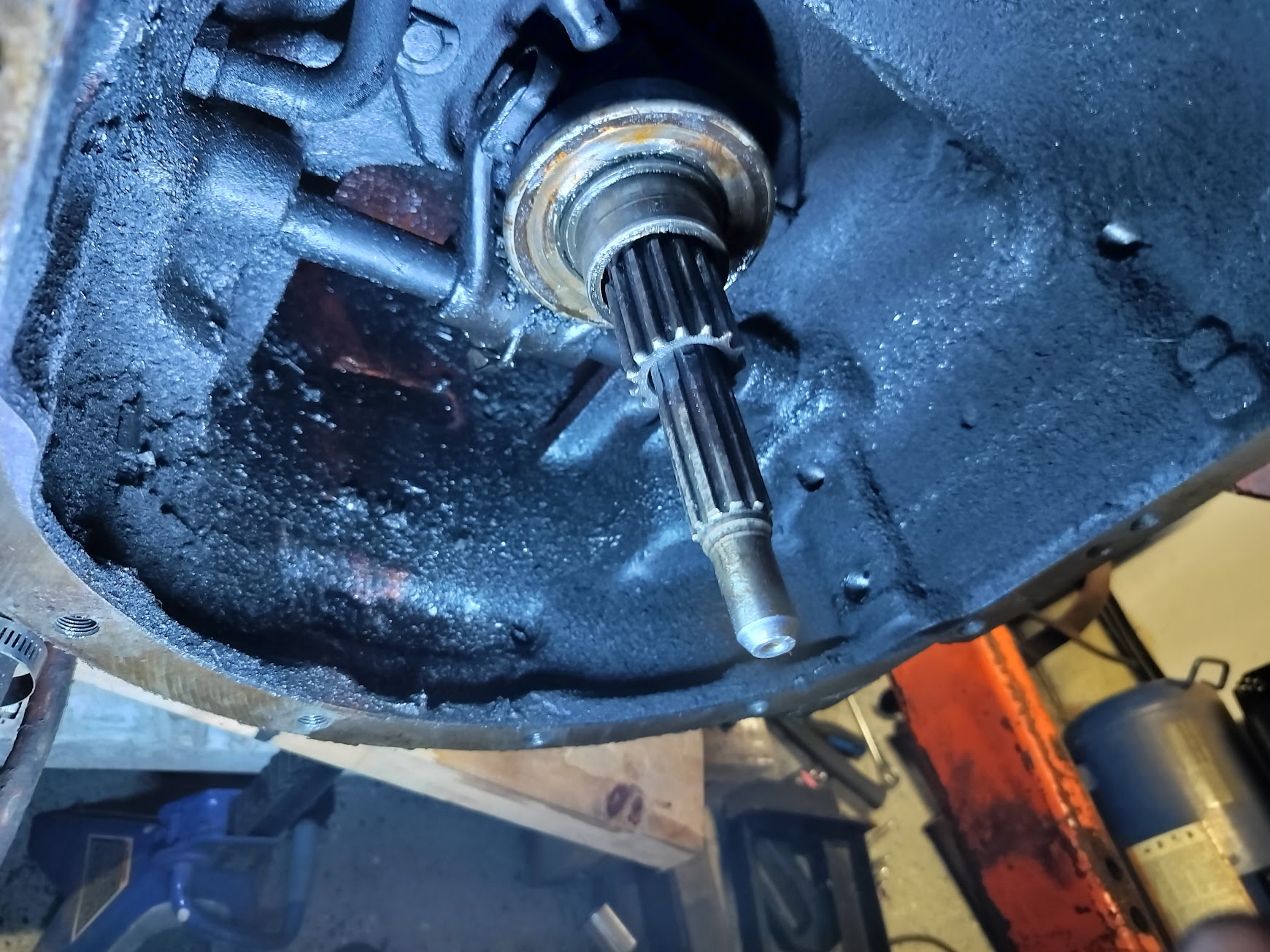

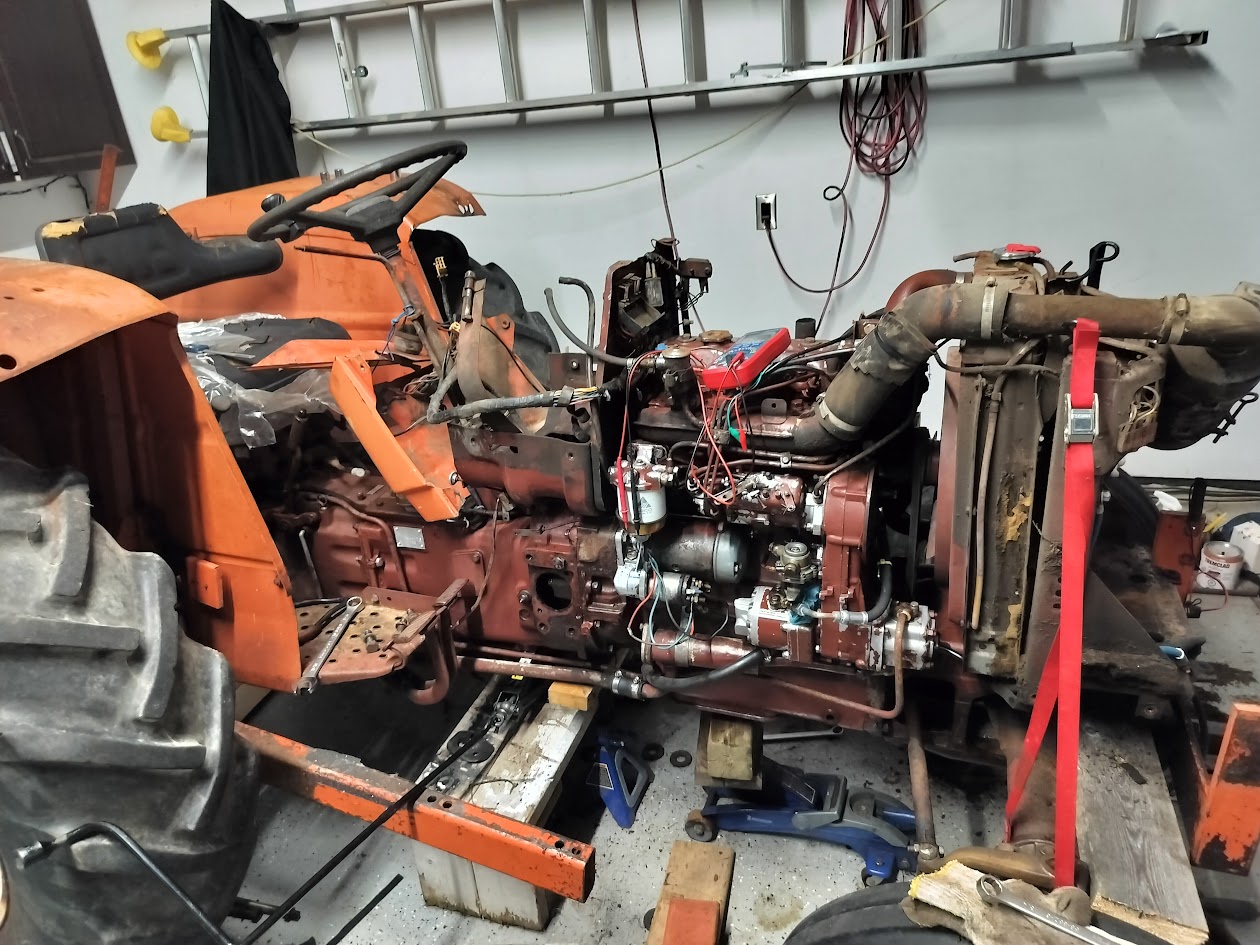

Split the tractor tonight.  Not dusty but greasy!  seems like alot of oil.  I had a half can of brake clean but I will run to town tomorrow and get a couple more cans.   Just so much to clean up.   The driven clutch is toast.  PTO clutch looks fine.  Throw out bearing and Pilot bearing also look fine.   I am not sure about the rest of it.  If anybody has specs it would be appreciated.  Trying to figure out next steps.   Here are some pics.
Points: 8370
Post Options Post Options   Thanks (0) Thanks(0)   Quote DougG Quote  Post ReplyReply Direct Link To This Post Posted: 27 Aug 2025 at 6:33pm
Wow- it is toasted,, Everything can be redone- gotta find the source of the contamiante,, might as well put a new rear main seal , and every seal thats in there

If it was mine I'd get an all new already set up clutch pack and with new PTO disc,plus new release bearings.Redid my Oliver 1365 4WD a few years ago,same basic set up used all new parts.Putting old parts against news ones in those units doesn't work out well most times.

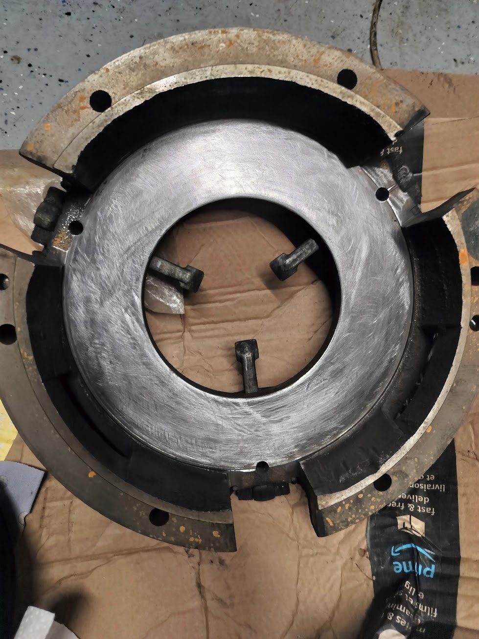

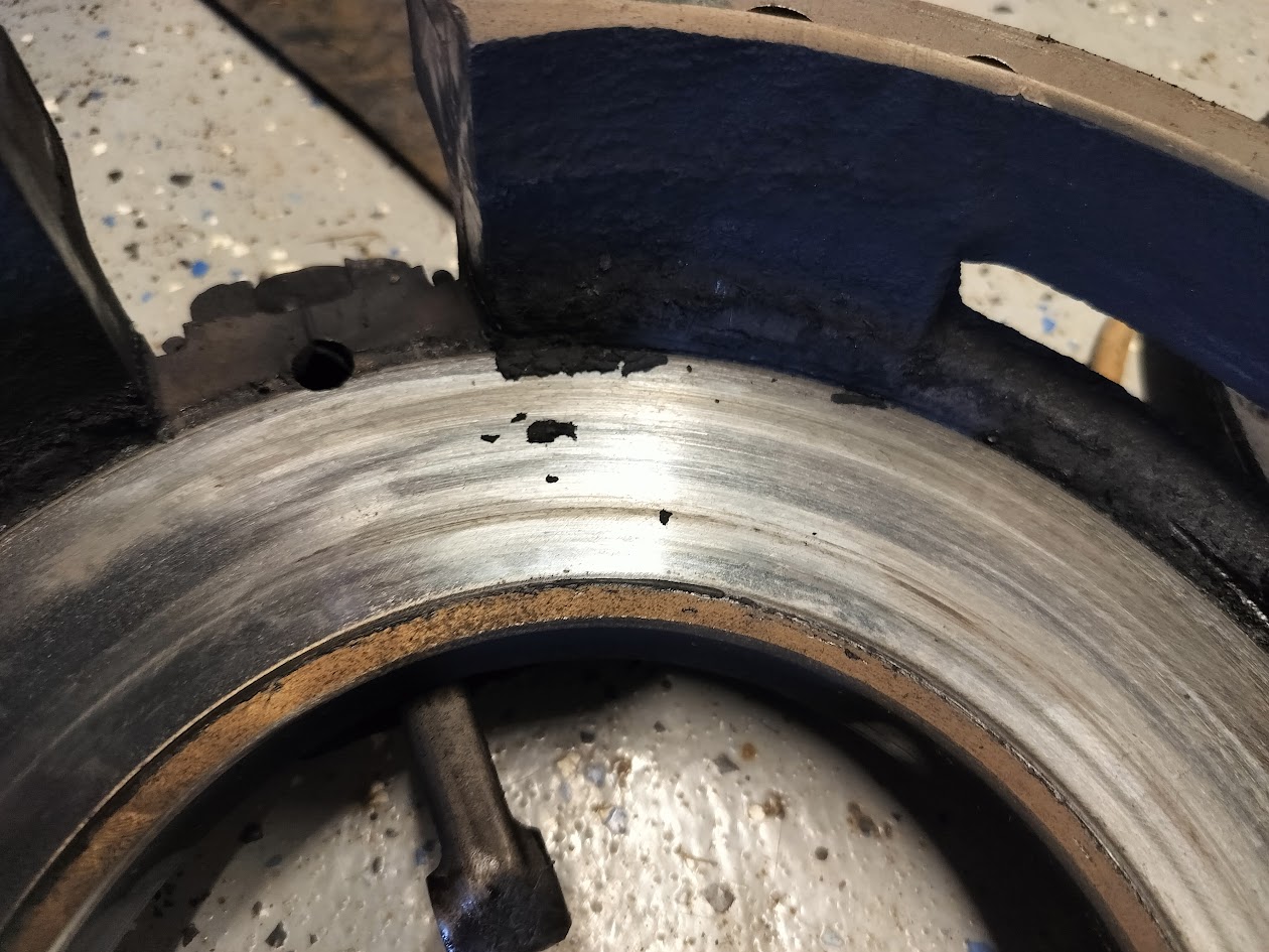

Behind the flywheel is dry,  transmission side has seen some oil.  Gonna work on cleaning it up tonight.  Got some products to degrease.  I knew going into this it needed a clutch.  I was expecting worse actually.  The flywheel is not bad, neither is the pressure plate.  Nothing to catch a finger nail on.  no ridge on the edges.   I am on the fence about spending the money or just throwing a PTO and Trans clutch at it. The PTO clutch is actually in really good shape.   The tractor is very easy to split.  not saying I want to do this again in a year.
I had mentioned the seller told me the transmission had been overfilled and was throwing fluid out the vent.  It was overfilled due to the loader.  Not sure if this pressurized the transmission and it could have blown oil out the input shaft seal.   The countershaft has a gasket.   We suspect it to be high hours and who knows how many hours since the build up inside the bell housing has been cleaned.  Ill send some more picture after its been cleaned up.

I would be much more concerned about preventing the leakage from happening again; therefore I would probably do the bare minimum of only replacing the transmission clutch in case of a repeat leak.
I have never so much as touched an Allis 5040 but I have done similar two-stage clutches on other brands. The main thing as far as adjustment is to keep everything even all the way around, and I do mean EVEN. Use a feeler gauge. It would be nice to have the specs but if you study the linkage it is not all that difficult to make them work correctly.

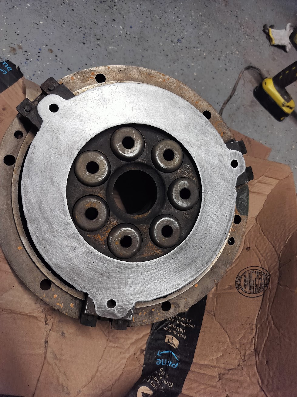

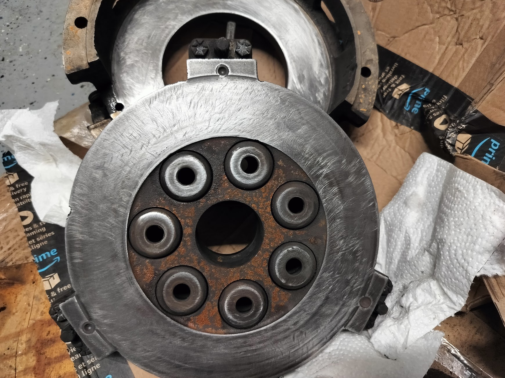

Just came in from the garage.  Got 90% of it cleaned up, with a tooth brush and some castrol super clean.  Same on the pressure plate.  degreased and then i hit the surfaces by hand with some 220.  I am looking for ridges that would tell me I would have reduced clamping.  I am not seeing that.  I think I am going to have to grab that service manual to check what the tolerances are, I assume this has been machined before.  hopefully tolerances are provided in the manual.

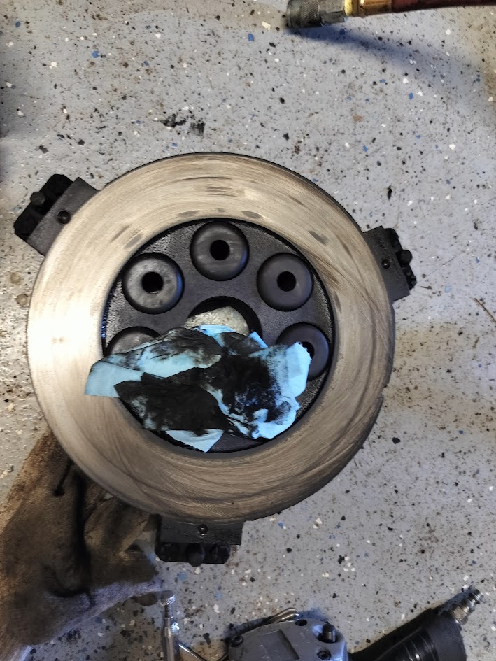

Also, see below a picture of the PTO pressure plate vs the Trans plate.  The trans / driven plate is closer to the transmission. PTO is still in pretty good shape.
The last picture is the vat of gunk that came out of this housing.  Might be normal for a 50 year old machine?

Post Options Post Options   Thanks (0) Thanks(0)   Quote lkennett Quote  Post ReplyReply Direct Link To This Post Posted: 28 Aug 2025 at 7:36pm
Pto Plate Vs Trans plate
