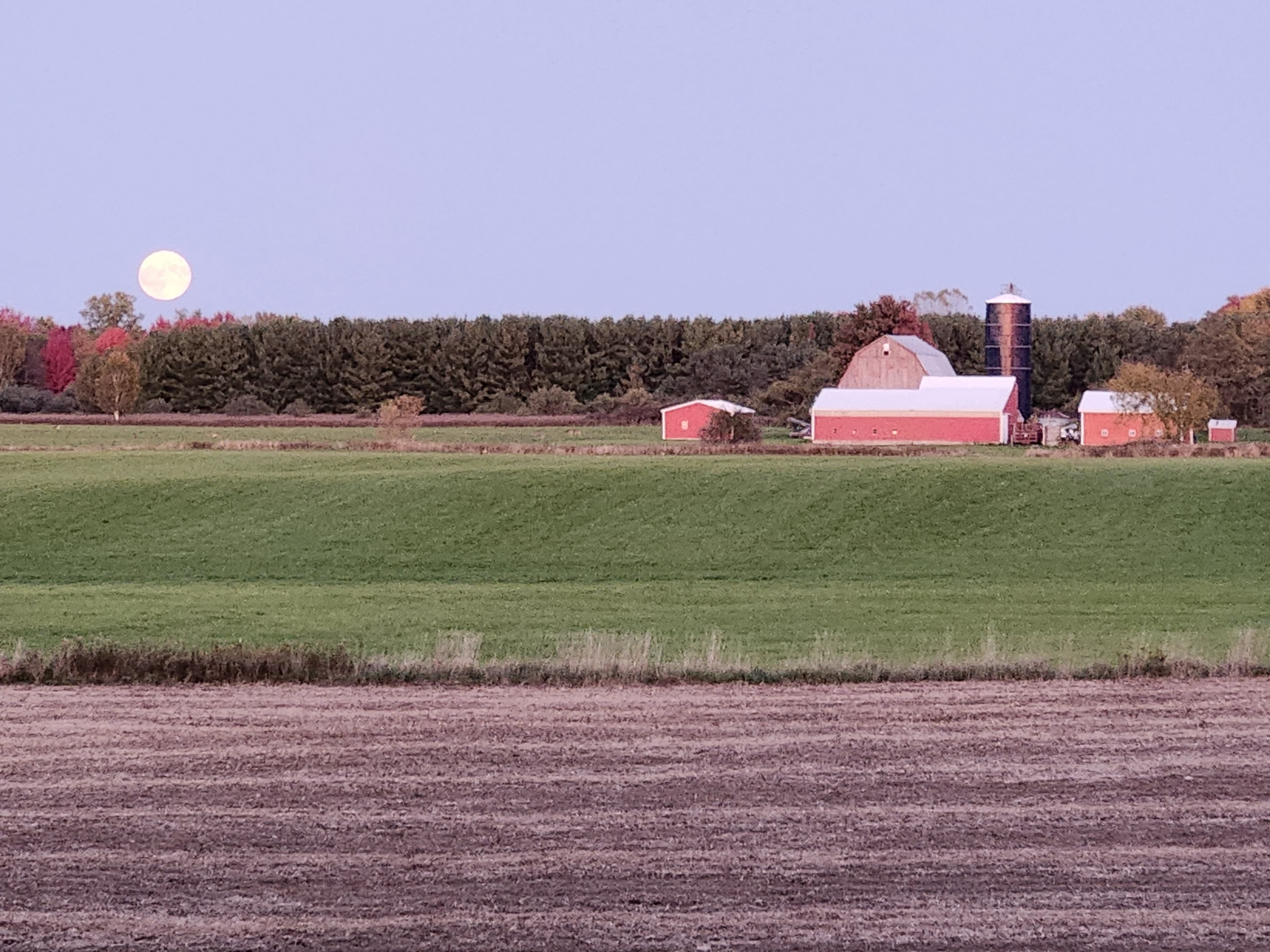

So here's the deal.
Growing up in my neighborhood, I never paid much attention to my Grandfathers Original Farm and Homestead property. He got divorced in the 80's and had to sell the farm, everything, including the farm home and barns. Because of this, I didn't really pay much attention to them and the fact was, when I grew up we went to grandpas other farmstead where he landed years later after everything settled out. That was "Grandpas farm" to me and my sister growing up in the 90's.
Fast forward to Today.
Because of the divorce, The Original home farm had 2 owners since then. The current owner, did put new steel roofs on the smaller barns and kept them up.
But the Original Hip Roof barn, that is on the homestead needs work. The roof is not terrible, but probably needs refastened and new paint. And of course the sides of the barn needs new paint also.
Here's where I'm at.
Because I do really care about family history, If I actually won the lottery I would donate money to the current owner to repaint it and preserve it. I know things don't last forever, and I know it's just a barn. But boy...now that I'm older I would hate to see it fall down because of neglect.
I know barns cost money to repair and fix. And it's probably cheaper to build a new steel Barn for storage. But the history is there. Take a look at these photos below.
Just wishing on my part I guess, that I could actually do something to help. (No I'm not climbing on the roof to repaint it, I would not do well up there).
What would you do? Would you talk to the current owner? See if there was another way to help? Maybe it's all foolishness on my part, just hate seeing another Barn go down over time. Let alone it's the family Barn with history...

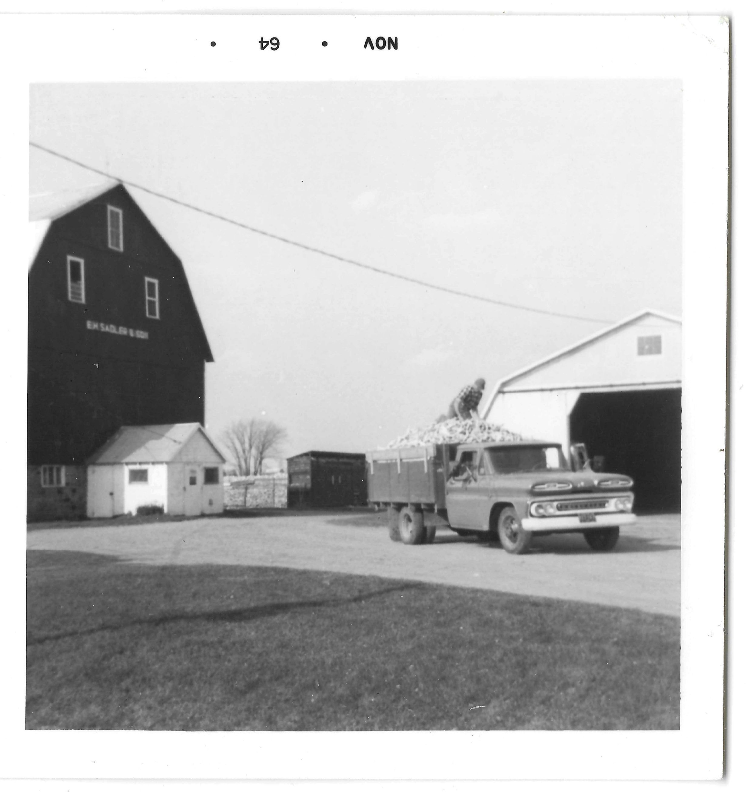

That's my Grandfather in front of the Barn

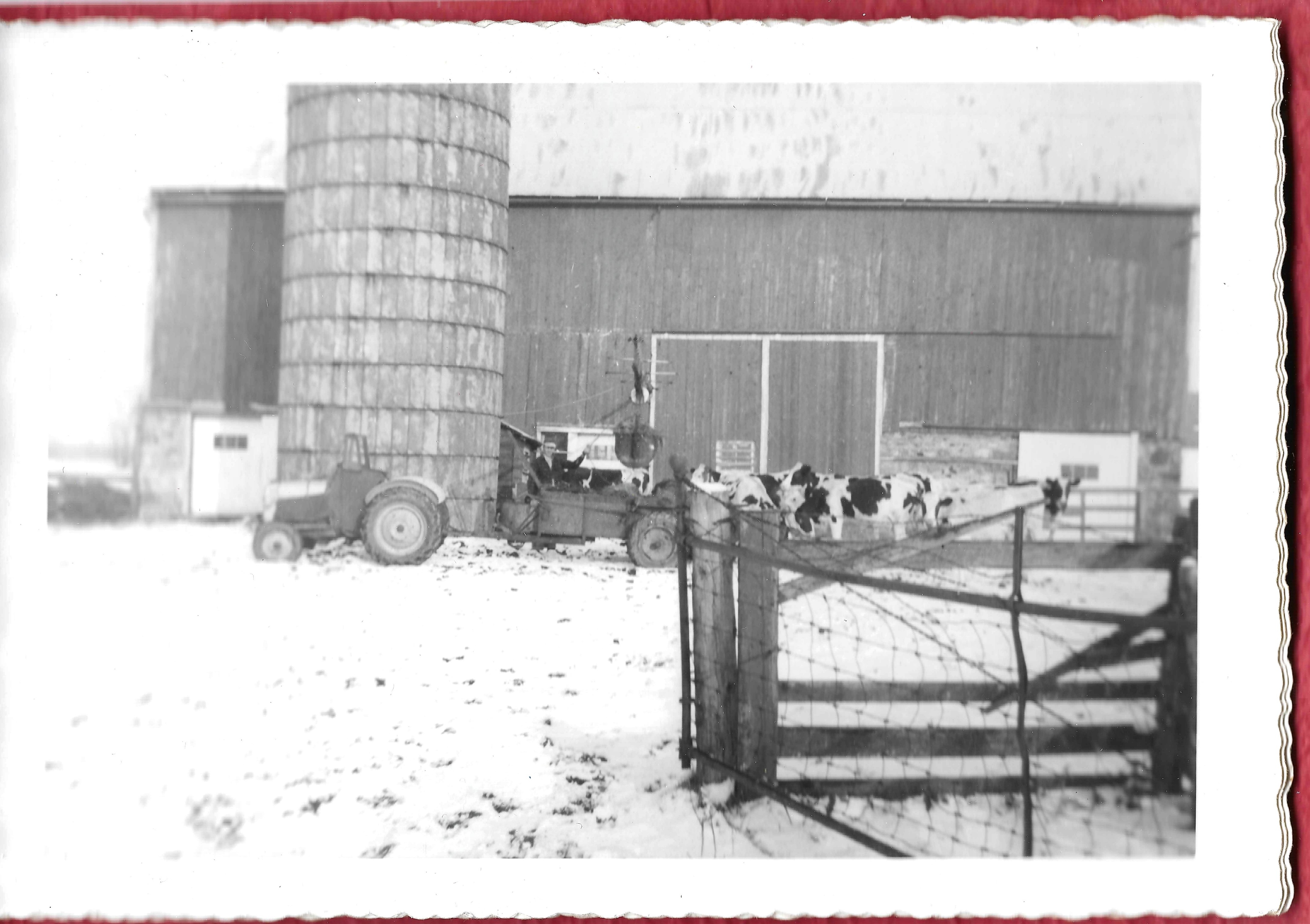

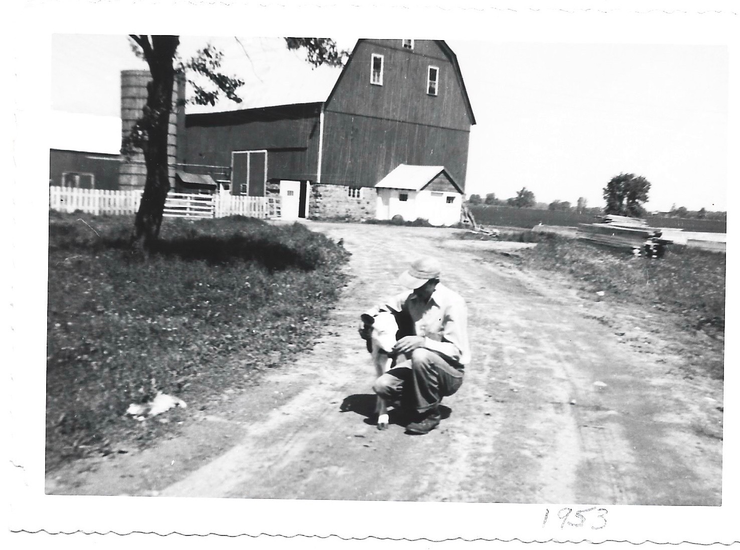

Currently Today
