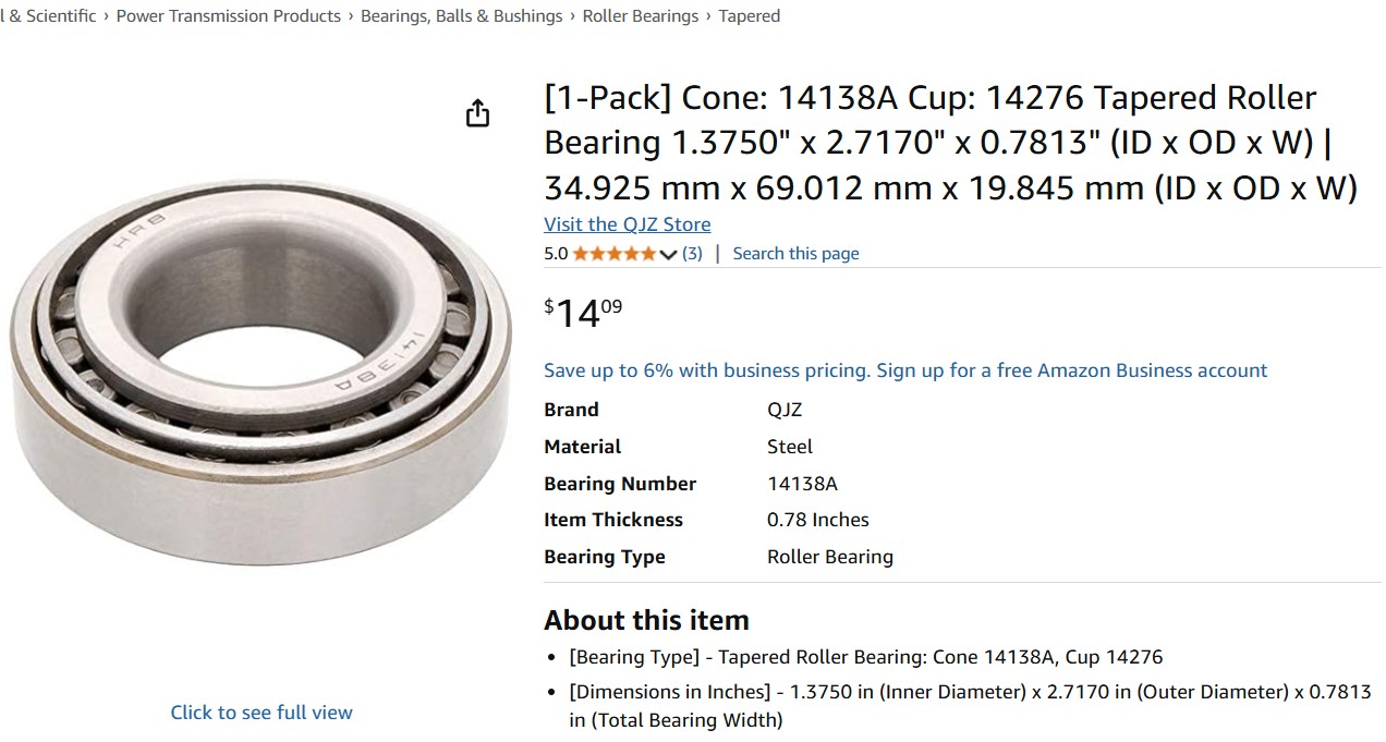

this is what i used years ago..........

that should be the OUTER BEARING on the PINION SHAFT...

the above is AMAZON... you should buy the RACE too... Yes, the RACE is pounded into the 4 bolt cover... bearing is pressed onto the shaft.. You may need to HEAT or CUT to get the bearing off the shaft ... try a puller first..
There are SHIMS on the cover to adjust the end shake on the bearings ... hold the cover up to the case with bearings installed ( 2 bolts) and measure the GAP between the cover and housing.. You want MINIMAL clearance.. No "CRUSH"..

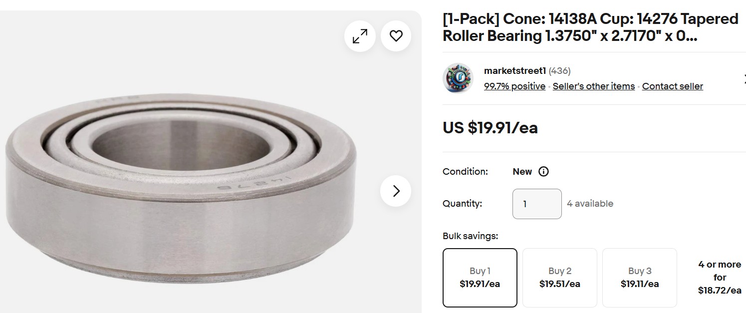

here is another option - e-bay...... you can also get at NAPA or local Auto Zone..

Thanks so much. My bearing on there currently is a caged rioller bearing not a ball bearing as pictured

Both pictures show caged roller bearings, just showing opposite sides of assembled bearing.

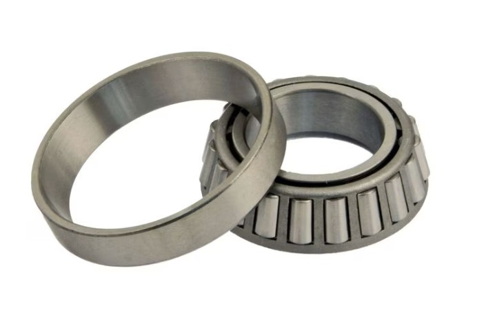

Post Options Post Options   Thanks (0) Thanks(0)   Quote steve(ill) Quote  Post ReplyReply Direct Link To This Post Posted: 08 Jun 2025 at 3:51pm
exploded view.....cone and race... 2 parts...
