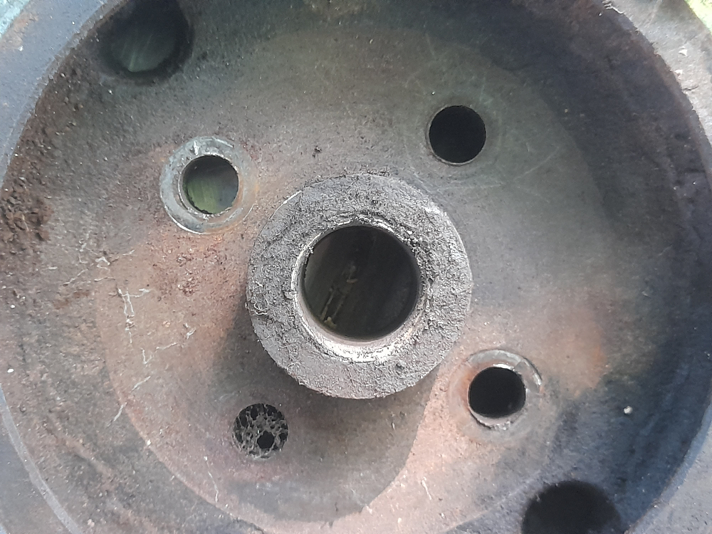

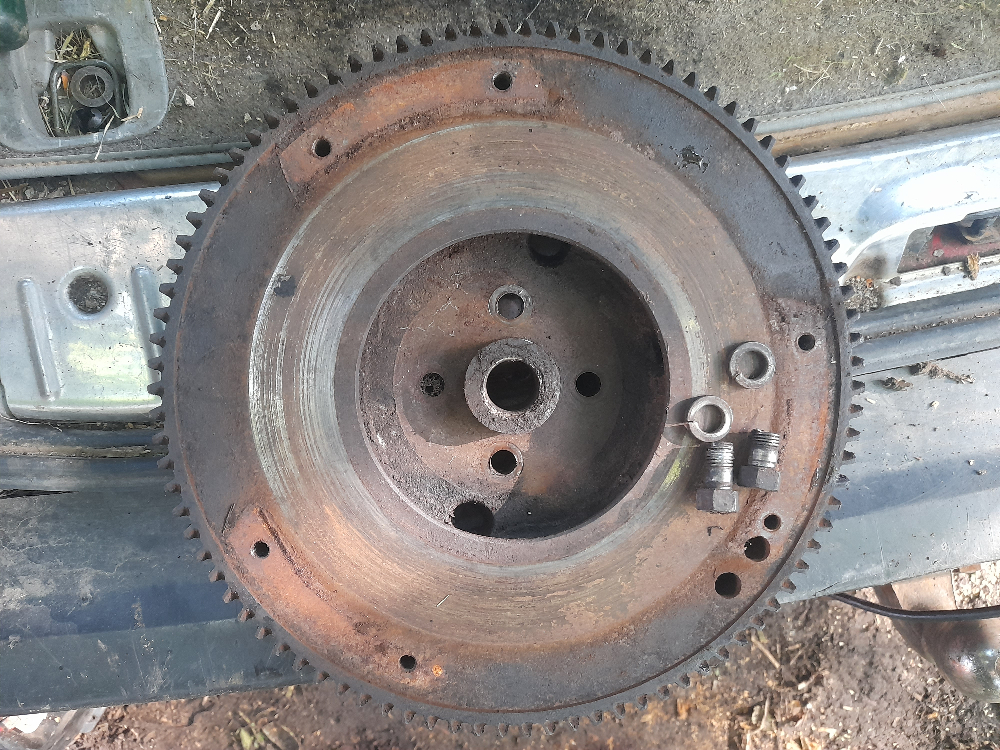

Anyway got the tractor split now and it's plainly obvious the flywheel was only ever on with two bolts (who knows how tight they were either?)
Will add photos later when we get home as on phone currently, but I'm just guessing cobwebs in the bolt holes ain't a good sign? Lol. Fortunately the crank seems ok and only one bolt is broken below the surface, other one is broken flush and threads look fine in the other pair so it's looking hopeful for a fairly quick n easy repair with just 4 new bolts and lock washers.

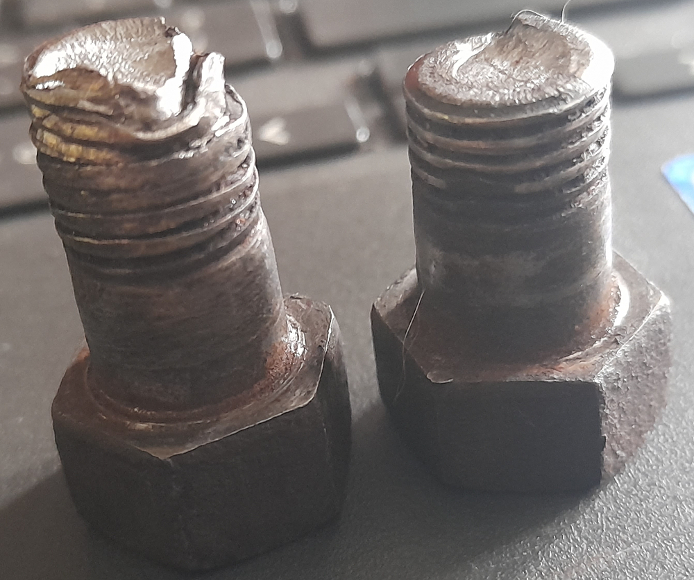

Yeah, got pretty lucky really. With luck should be photos of the minor carnage now, along with spider webs where bolts ought have been!
Looking at the broken bolts I'm going to say they were not particularly tight, looks like one broke from fatigue and the second one began working it's way loose (there's my noise!) before also shearing.
Just a tiny scar on the crank that needs dressing with a file, and extract the broken bits of bolt & be back in business.
