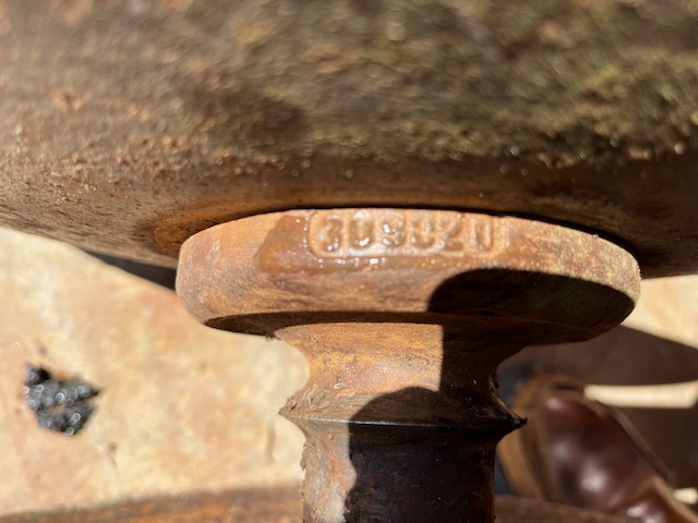

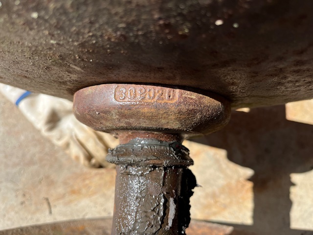

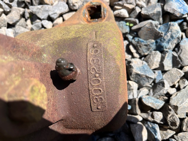

Mike,
You were right!!  the bearings ARE wood.  just so old and greasy I couldn't tell at first look.  Here's some pix of what I'm looking at...  I could use 1 of the bottom half of the bearing "holder"...part #300236.  Also, one of the bearing spacers (number is hard to read...309020 or 309C20?)

here's another pic

one more picture...

if what you have is in fact a 9A  the part number for the bearing is 300224 , i already inquired  about these with the guy in upstate ny and he claims he doesnt have any. they are  made of rock maple  as was very common practice in those days. To install soak them in hot oil for a  while then install and grease them like you got the grease for free. re grease every 3 to 4 hours
this woodex outfit will made anything you can dream up but its comes with a price i got a quote a number of years back and it was eye watering and at this point its  probably doubled since then.
the rifle bored hole down the middle if you are making them i think is 1  15/16   and the hole on the side is 1 inch if i remember correctly.

Thanks for this, Juniorp53.  the measurement for the ID on the bearing is very helpful!!  I have a guy doing some cast iron weld on the part that's broken...fingers crossed it works!
