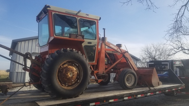

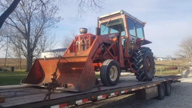

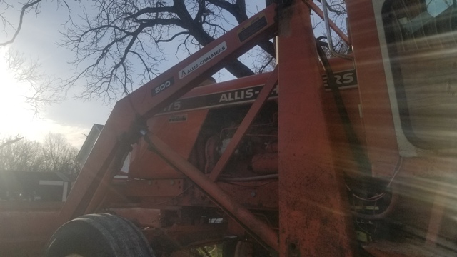

Hauled this in this morning:
Codger View Drop Down
Joined: 23 Dec 2020
Location: Utopia
Points: 2726
Post Options Post Options   Thanks (0) Thanks(0)   Quote Codger Quote  Post ReplyReply Direct Link To This Post Topic: Hauled this in this morning:
    Posted: 21 Mar 2025 at 10:06am
Very nice running 175 diesel tractor. Internal hydraulic leak someplace. Steering is very choppy as is loader operation. Started right up at 34 degrees and owner says it's a good tractor.

First thing I brought up to the owner and we checked. Reservoir was full and clear oil. Going in for repairs and full routine service as due. I didn't see any oil leaks and all cylinders appeared tight.

He purchased it new and it's his feeding tractor for cattle. The receiver hitch welded to the bucket floor allows for a bale spear to be installed and removed easily.
It's getting a full routine service while in the shop along with whatever is wrong with the hydraulic function(s) repaired.
