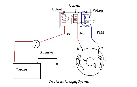

Post Options Post Options   Thanks (0) Thanks(0)   Quote steve(ill) Quote  Post ReplyReply Direct Link To This Post Posted: 12 Nov 2024 at 7:44pm
here is a generic diagrom of a GENERATOR with a REGULATOR..... you can mark either battery teminal + or neg..... still wired the same..
Points: 89968
Post Options Post Options   Thanks (0) Thanks(0)   Quote steve(ill) Quote  Post ReplyReply Direct Link To This Post Posted: 12 Nov 2024 at 7:47pm
one test is to take a JUMPER WIRE and clip on the "F" terminal of the generator and GROUND it to the tractor frame/ engine... If that makes it charge, then your REGULATOR has a problem..... If you dont see the amp meter jump, then put a volt meter on the "A" terminal to ground and see if the GENERATOR is putting out voltage... and the regulator is bad.
