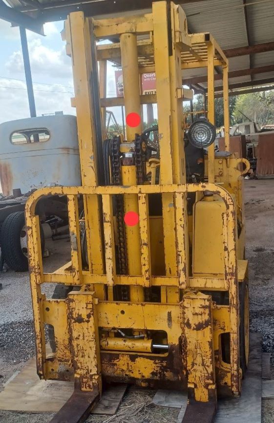

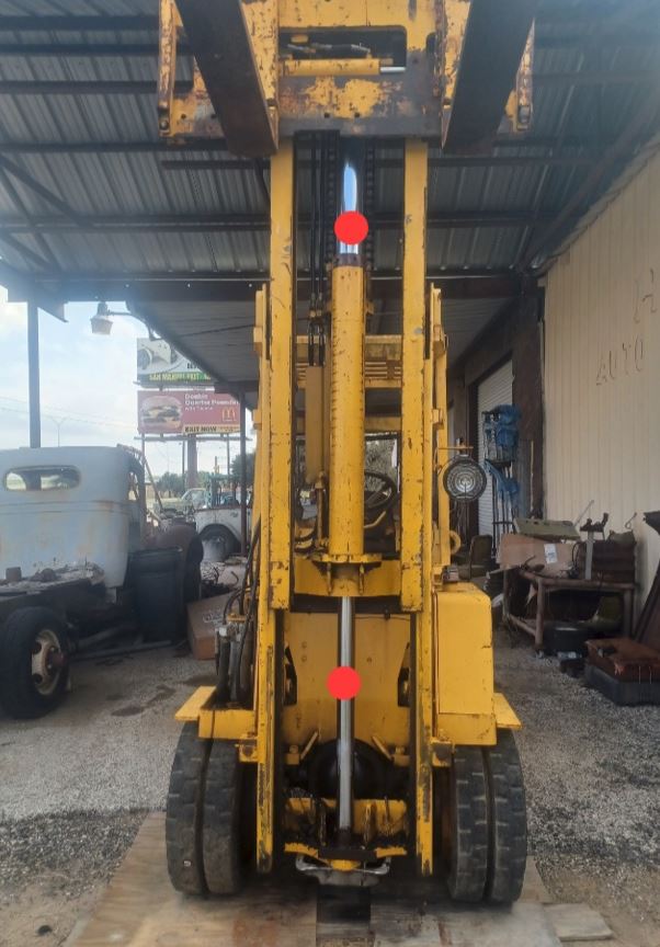

I have an ACC 60 DS. My mast cylinders seals are leaking.   Can someone give some help in repairing these seals. Or is there a manual somewhere? Don't know how to approach this as I don't know know how to remove the cylinders to repair them. Thanks, Joe.

To remove that cylinder is definitely labor intensive. You really should be two persons and some form of a lift to do this repair job. if you haven't previously worked with resealing cylinders your best choice is to find a trustworthy and reasonable mechanic or hydraulic shop to refurbish the cylinder with new seals. The seals will be common types and sizes so they don't have to be Allis-Chalmers parts.
I'm including a link for a A-C forklift manual for sale, although with the right kind of help you may not need it for this repair job you're doing.
