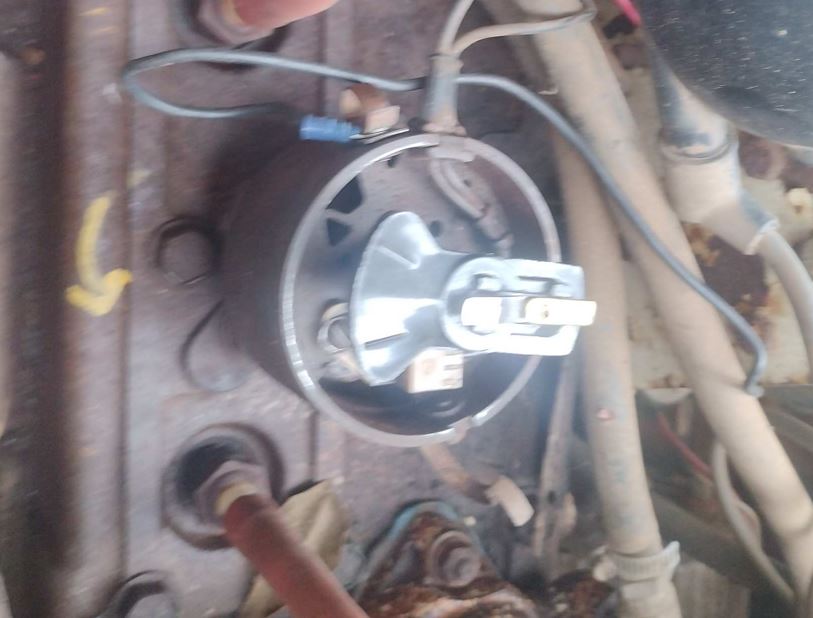

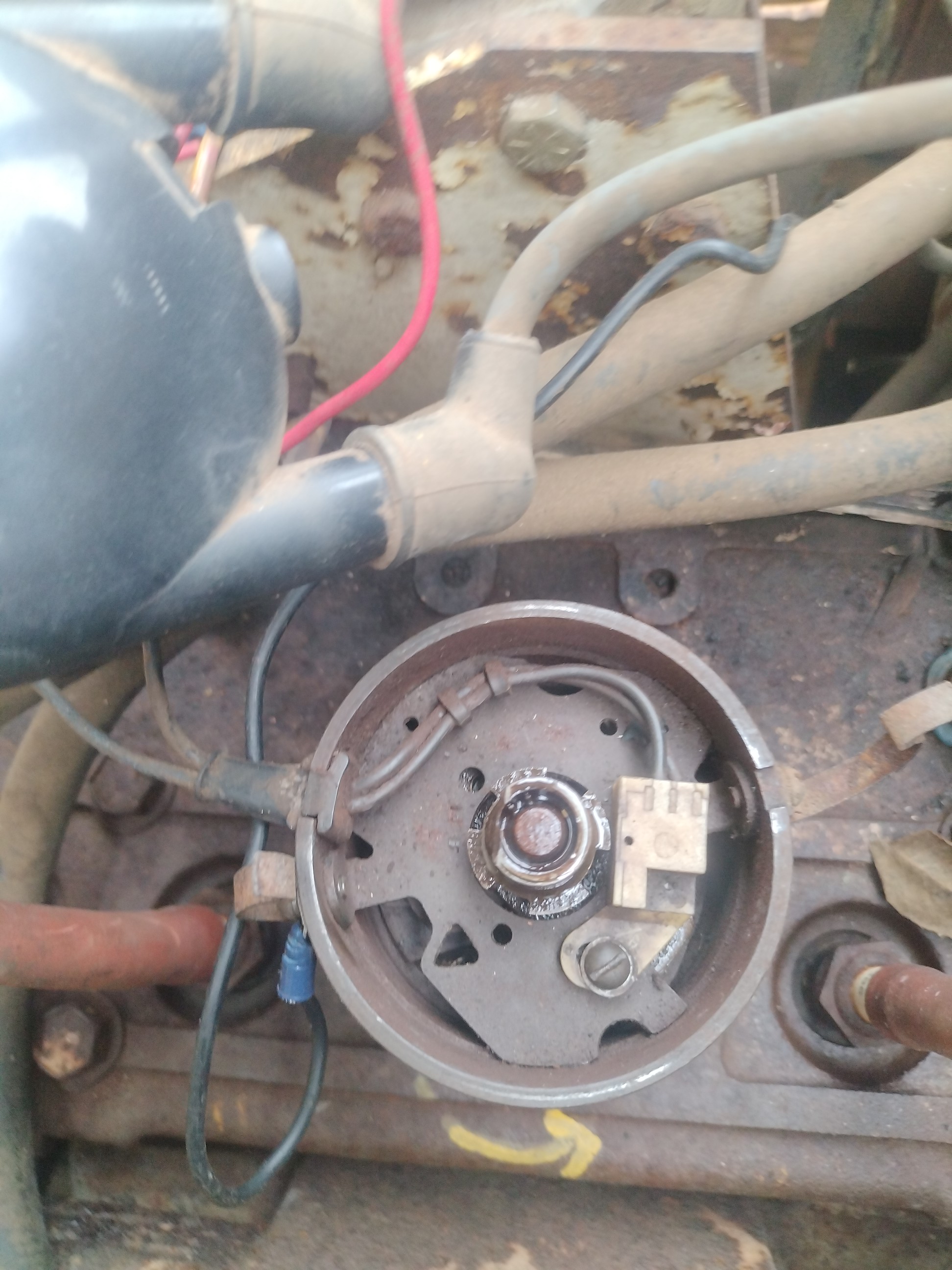

I am not familiar with that particular ignition system, it may be helpful if you could post a photo of the distributor with the cap removed so we could see what type of reluctor and sensor/pickup it uses.

Post Options Post Options   Thanks (0) Thanks(0)   Quote bigcrunch Quote  Post ReplyReply Direct Link To This Post Posted: 07 Nov 2024 at 12:40pm

Post Options Post Options   Thanks (0) Thanks(0)   Quote bigcrunch Quote  Post ReplyReply Direct Link To This Post Posted: 07 Nov 2024 at 12:41pm

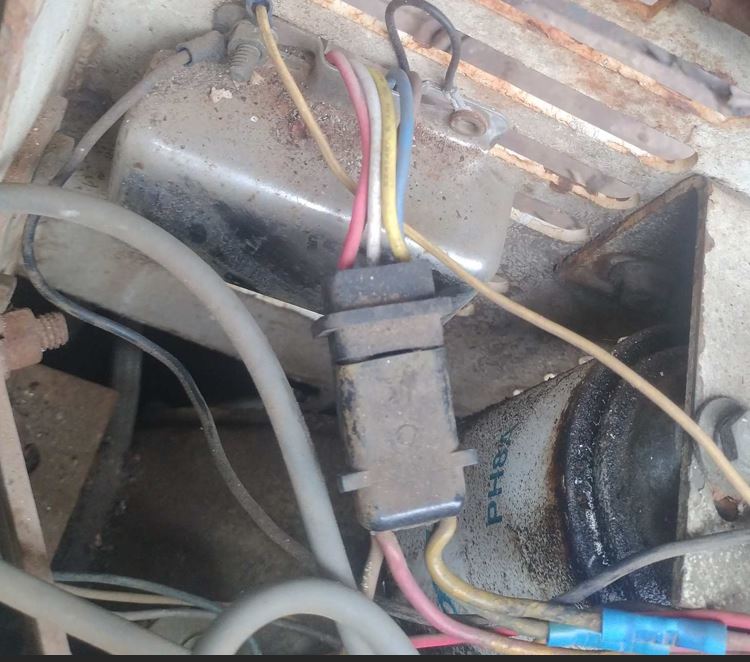

Post Options Post Options   Thanks (0) Thanks(0)   Quote bigcrunch Quote  Post ReplyReply Direct Link To This Post Posted: 07 Nov 2024 at 12:42pm
I posted 2 replies one with distributor other with the ignition module I tried to combine them but got an upload error.
Better view of pickup module,  looks like stock Prestolite???

the Petronix should be an UPGRADE... and "visually" you will not know the difference from stock... Why not Eliminate the old "ignition box" ?

I installed a replacement ignition box, it is lighter and the backside has less "rubber" filling tells me it has less - different electronics in it, may be better longer lasting !!??
I rewired my ignition per hot-spark.com  diagram where the power to the ignition box goes thru a ballast. It started right up ran smooth, there are more items to address on this lift before I use it.
