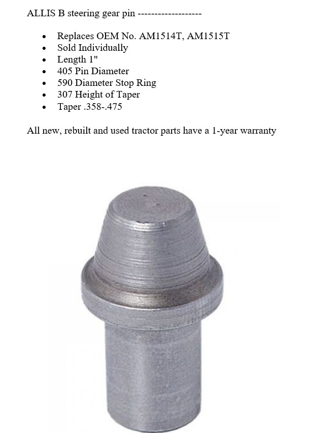

Can someone please tell me if the pin that rides inside the worm gear is round or oblong? I have looked at various pictures and it appears to be round and somewhat coned down. I need to build mine up and like toget it shaped right the first try.if anyone has any measurements that would be great to...Tia
Points: 89968
Post Options Post Options   Thanks (0) Thanks(0)   Quote steve(ill) Quote  Post ReplyReply Direct Link To This Post Posted: 25 Oct 2024 at 2:19pm
saw this on the internet several years ago.. I made a couple useing these numbers.

That helps a lot thank you.
