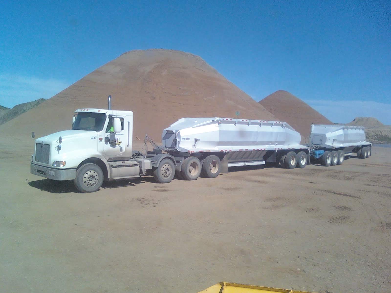

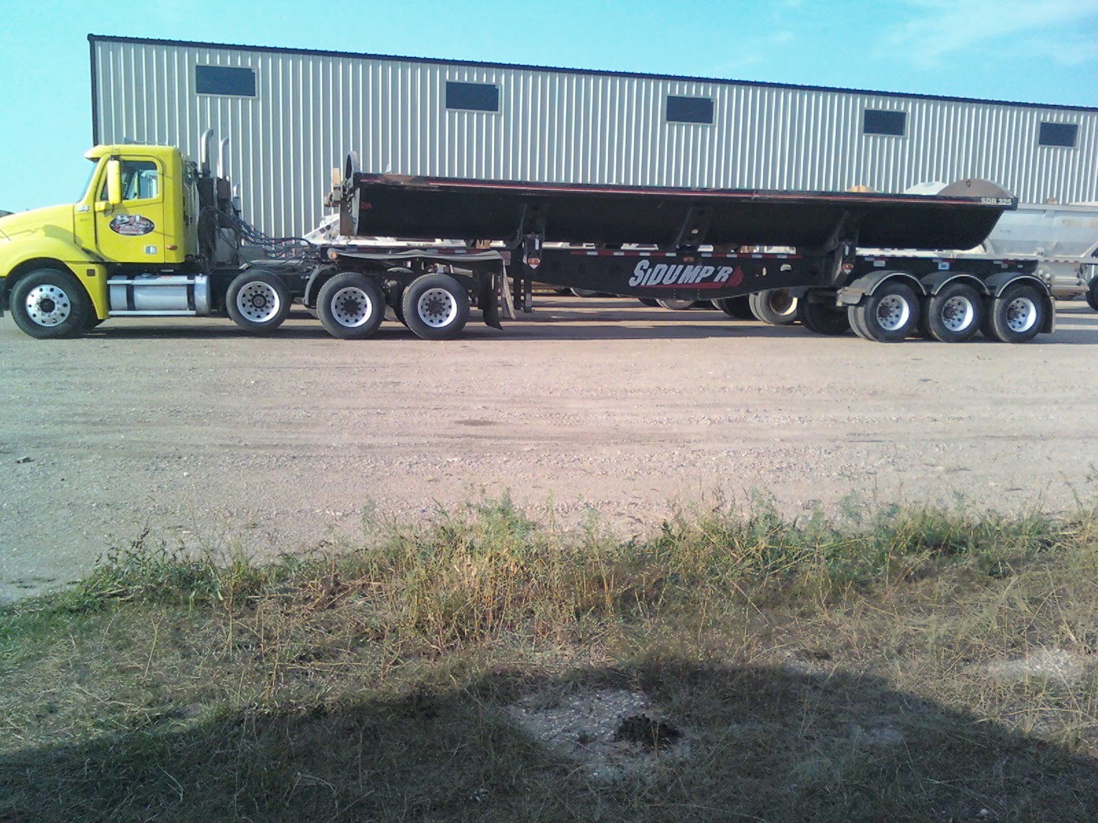

Post Options Post Options   Thanks (0) Thanks(0)   Quote truckerfarmer Quote  Post ReplyReply Direct Link To This Post Posted: 06 Oct 2024 at 10:21pm
I've played the bridge formula game. These are a couple of the rigs I've run. The double belly dump was legal for 142,000. The sidedump as I recall was legal for 94.500.
