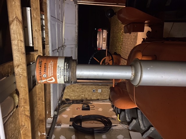

I've had a flapper on my B for years, but still throw a Folger's plastic coffee container over the flapper just for extra protection. Had to change a couple out over the years due to the UV rays, but as long as Jo Jo keeps drinking Folger's I'm in good shape for a exhaust stack cover!  LOL!  Thumbs Up

This is my rainguard! Have been using it for 50 years. When not in use it stays in that cubby hole in front of fuel tank on WD45. So it is always with the tractor. I think I deserve 1st prize for this but I know I’m biased!!! šŸ˜€šŸ˜€
Edited by Ed (Ont) - 24 Sep 2024 at 8:00pm
Albertfitch View Drop Down
Joined: 13 Nov 2011
Location: Dunkirk , Md
Points: 34
Post Options Post Options   Thanks (1) Thanks(1)   Quote Albertfitch Quote  Post ReplyReply Direct Link To This Post Posted: 24 Sep 2024 at 8:35pm
Hi Ed clearly love your sweet Allis as I have mine ..after her first 10  faithful years under a tarp  I moved her into the barn . After 20   I let her share the garage , and moved my fickle  chevy out .  Last year I took the couch  and my wife;s lazyboy  and stored them  in  the driveway pod and then moved old faithful Allis into the living room . She's , a 65  yo  Italian beauty still stunningly beautiful If you dear helpful brothers on the forum spot her  please let her know  I moved Allis out from in front of the TV  You're all great I ran her for 4 hours today  after the re-torque and Bars sealer and I think  it worked  All THE BEST ALBERT
