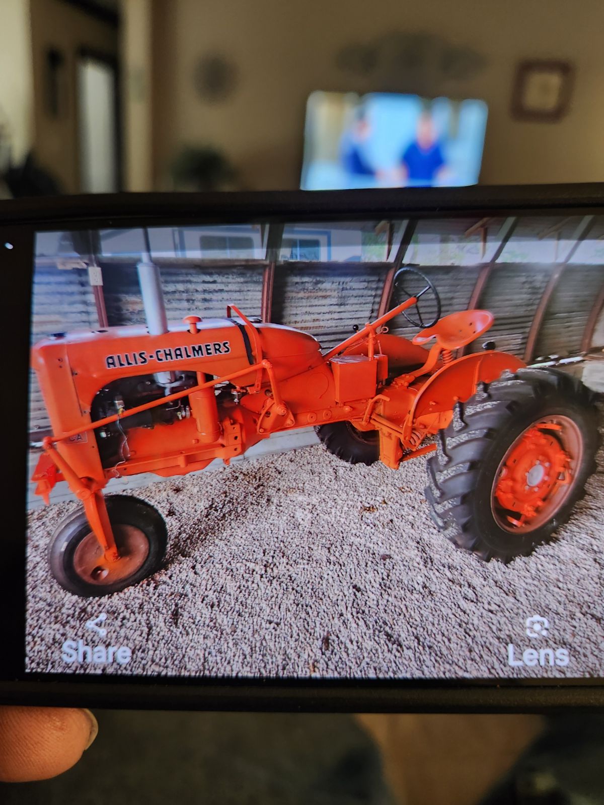

I have a Allis CA that I trying to fire up. Head Professionally re-worked, all new everything. Great Compression on all 4, Hot Fire and clean gas..6 volt system.
