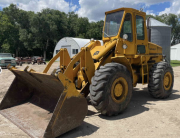

You see those 3 hooks on the bucket? yours is already set up for an over the bucket style fork...Wink
Length and diameter of the bar TBD by the hooks and their spacing on the bucket...

Well, now that is interesting, learn something everyday!  Didn't realize there was a fork over bucket configuration, thanks for sharing!  It looks like it provides alot of convenience when needing a bucket one minute and forks the next.  That may be something I want to invest in.
I did read that there will be some reduction in lifting capacity and looking at some of my projects such as moving alot of stationary "stuff" around, I think I still want to go with a dedicated set of forks.
Is it safe to assume that the correct forks are unavailable unless I can find on Ebay, junkyard, etc??

A good assumption. Note the link I provided was the first one that had a picture, when I googled over the bucket forks...  You might have a welder rig you up a set.  Problem with otb forks is letting an idiot use them, especially on undulating ground. Sod pallets are what they were mainly designed for.  The alternative is bucket forks that clamp to the bottom of the bucket, but they can bend the bottom of the bucket with a heavy load, and are prone to pulling off, when backing out...Wink
