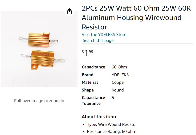

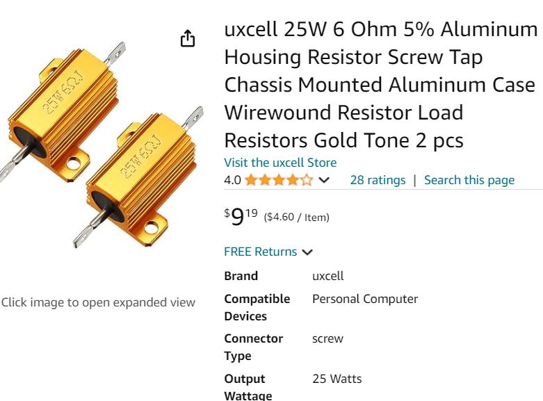

  OK, Guys,,as I have repaired the 12 volts going to ground at the timer,,I am on to completing the wiring in engine compartment and now find one of the two resistors is possibly bad. The 12 volts will not go thru it,, from either direction. on one corner of the porcelin  body it has the following : 60 followed by the OHM icon, 10%25 W,,,? What do I order??,,,Or does the engine even have to have  it to run? There is a second resister that did not have any wires connected to its terminals,,,??
  Hey Jay,,I ain't forgot you, I still am having issues with trying to post pics hoping ole Buckskin agrees to help me get all my pics in one place so I can find em,,,,,????Wink
Edited by desertjoe - 31 Jul 2024 at 7:53am
Points: 24728
Post Options Post Options   Thanks (0) Thanks(0)   Quote jaybmiller Quote  Post ReplyReply Direct Link To This Post Posted: 31 Jul 2024 at 8:28am
that's a sixty ohm, 25 watt resistor though I suspect it might really be a SIX ohm ( get  extra eye power and see IF it's says 6.0 ohms. Itty bitty decimal point between the 6 and the 0.
Points: 88197
Post Options Post Options   Thanks (0) Thanks(0)   Quote steve(ill) Quote  Post ReplyReply Direct Link To This Post Posted: 31 Jul 2024 at 2:10pm
Joe... i have no idea what your resistor is, but as Jay said "MOST COILS" for tractors / cars are in the 2-3 amps size... so yours might be a 6 ?? .......... 60 would be odd , unless i just dont understand your system..
Points: 88197
Post Options Post Options   Thanks (0) Thanks(0)   Quote steve(ill) Quote  Post ReplyReply Direct Link To This Post Posted: 31 Jul 2024 at 2:15pm
and YES... there are 60 watt resistors (AMAZON) if that is what you need..
