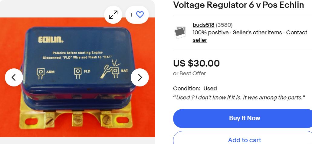

DO NOT BUY THIS.... just showing you such an animal does exist... 6V pos ground.

The regulator in the ebay picture shows polarizing instructions for a "B" type used by early fords. You removed the field wire and touched it to the bat terminal. Delco used "A" circuit where you use a jumper between arm & Bat terminals to polarize. On a delco if you jumper from fld. terminal to ground the generator should charge wide open, bypassing the regulator. Never touch field to bat on an A circuit.

Terry is right... I was just showing that Echlin DID make a 6v POSITIVE GROUND voltage regulator... YOU DONT WANT THAT SPECIFIC ONE.. but you DO WANT a 6V.
Excellent post.
The original poster showed a photo of an "A" circuit regulator, it is crucial to have the correct type.
