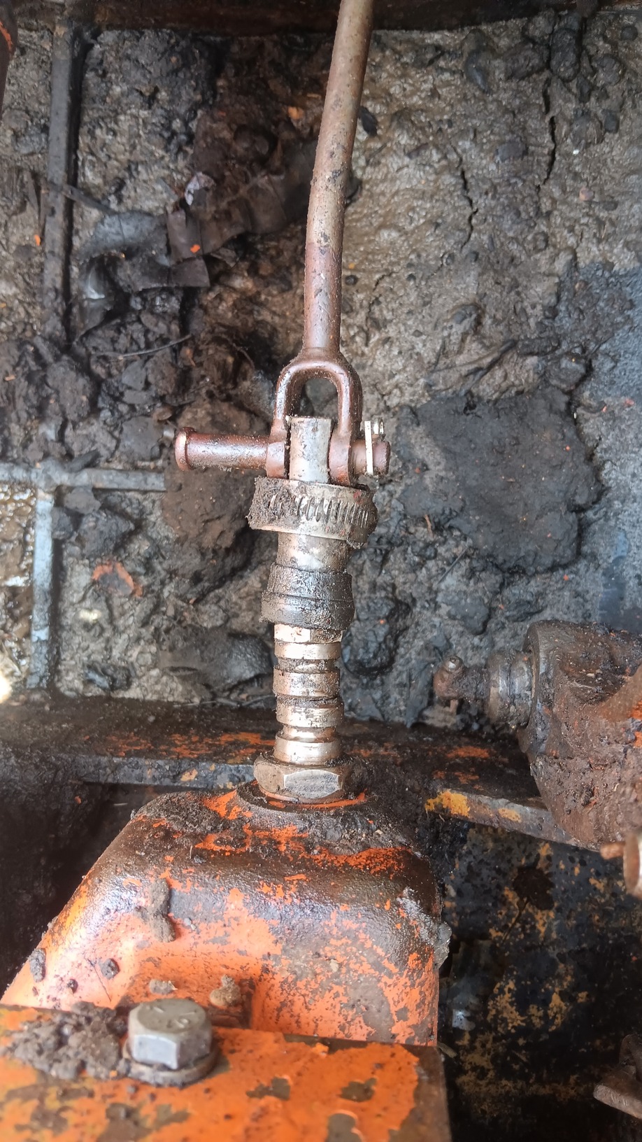

What is the proper way to seal this up. Lost like 50$ worth of oil in no time. Sae 50 isn't cheap...

He should have a boot seal on that rod

Yes a rubber boot. That rod locks the gears in place so they don't jump out of gear. Rod is released by movement of the clutch lever.

Well after feeling like an idiot thinking it was leaking from the plunger, I put close to 5gal back in and now it's not leaking that I can see, except for inspection plate. I wonder if the shaft seal or pinion seal was dry and needed oil to swell up? When I first drained the oil, it was real brown and only about a gallon and half.

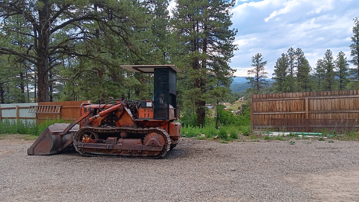

Thank you everyone for help and CAL for locating the replacement boot. I will order one now. As far as the oil, I'm sure it will work fine with gear oil, im not sure I want to take the chance on accelerating failure on this already aged transmission. I am about to start what I estimate will be 50 hrs of dirt work and I'm praying I get that out of this machine. Thank you all for the continued support and answering my questions. Forums like this have saved me so many times. God bless.
Edit* here's a picture of the canopy I threw together real quick. Works pretty good

Maybe not understanding what all is going on, but have replaced several rubber boots as that rod can leak a lot.
