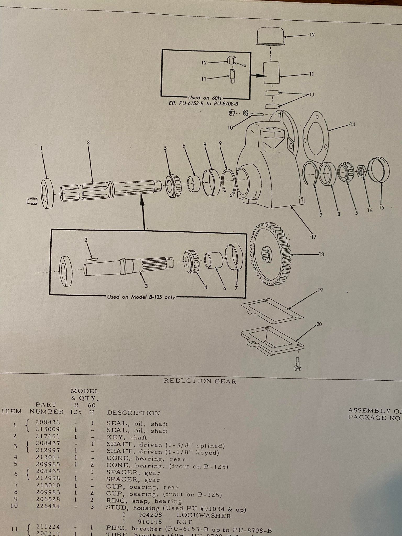

I finally got around to changing the left final drive oil pan gasket on my 52 model B. I needed to be changed as it was leaking out of the front side of the pan. Got the old DIY rubber gasket off and replaced it with the Steiner felt gasket. Took it down the road for a spin and it looked like it was leaking even more than before! Upon further inspection it looks like it's not leaking from the oil pan but now there is a large drip coming from the bottom of the opening for the drive shaft.
Looking at the parts diagram I see that there is a drive shaft seal (#1). I'm sure this is what is leaking, but the question is why now and not before? Is the drive shaft seal only to keep dirt out? Maybe I over filled the pan and that's why it's leaking? I opened the pan fill hole back up and stuck my pinky in there to check the level and it had dropped quite a bit.

the oil level is low in the pan and the gear dips in the oil and flings it all over the inside.. The shaft is a few inches ABOVE the oil level. There is not way you filled the pan and got oil up to the shaft.. Normally you can remove the wheel hub and pull the seal out and replace it... But YOUR TRACTOR has the FLANGE made onto the shaft .( yours is a Potato or CANE tractor ???) . There were a few made that way.... You will need to remove the hub and rim.. remove the pan.. pull the bolt off the INBOARD bearing end and pull the shaft out  OUTBOARD end from the bull gear.. to get to the seal..

Thanks John and Steve. Y'all are always super helpful. Looking at it I kind of knew I would have to disassemble that whole side of the rear end. I'm looking at Steiners and they have 4 different options for rear oil seals but none of them match the part number in the parts diagram. Does anyone know which one would be the correct one? They are all different diameters and thicknesses...

Im not sure where you got the diagram above, but its not quite right... The "B" tractors have a nut on the inside and the shaft it threaded behind the bull gear.. nut screws on and holds the gear from moving... not a lot of clearance in there for a BIG wrench.. I think i made a wrench out of 3/8 inch plate.... the nut is about 3 inches OD ( approx as i remember).
