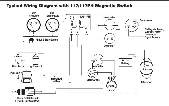

Post Options Post Options   Thanks (0) Thanks(0)   Quote steve(ill) Quote  Post ReplyReply Direct Link To This Post Posted: 14 Jun 2024 at 9:41pm
here is the wire diagram for a BASIC Murphy Switch... yours may be more or less complicated... but the TERMINALS on the Murphy should show where the wires go..

Well I managed to get it going. Was a mix of things but mainly a leaky diaphragm on the fuel mixer and a bad resistor. It wasn't getting quite enough fuel due to a leak in the diaphragm so the engine vacuum wasn't enough to open the gas valve far enough to let the proper amount of fuel through. As far ar the resistor the longer I cranked the engine the weaker the spark got even though it was cranking fine. The second wire from the starter is only energized during cranking and basically bypasses the Murphy. As soon as you let off the key that current stops and the Murphy takes over provided that the oil pressure and temperature are good. Thanks for the replies.
