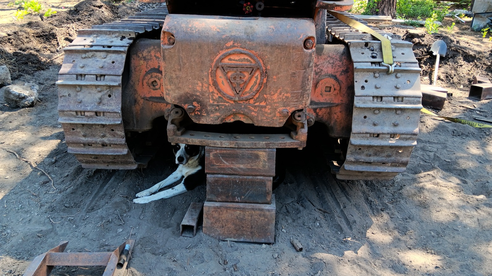

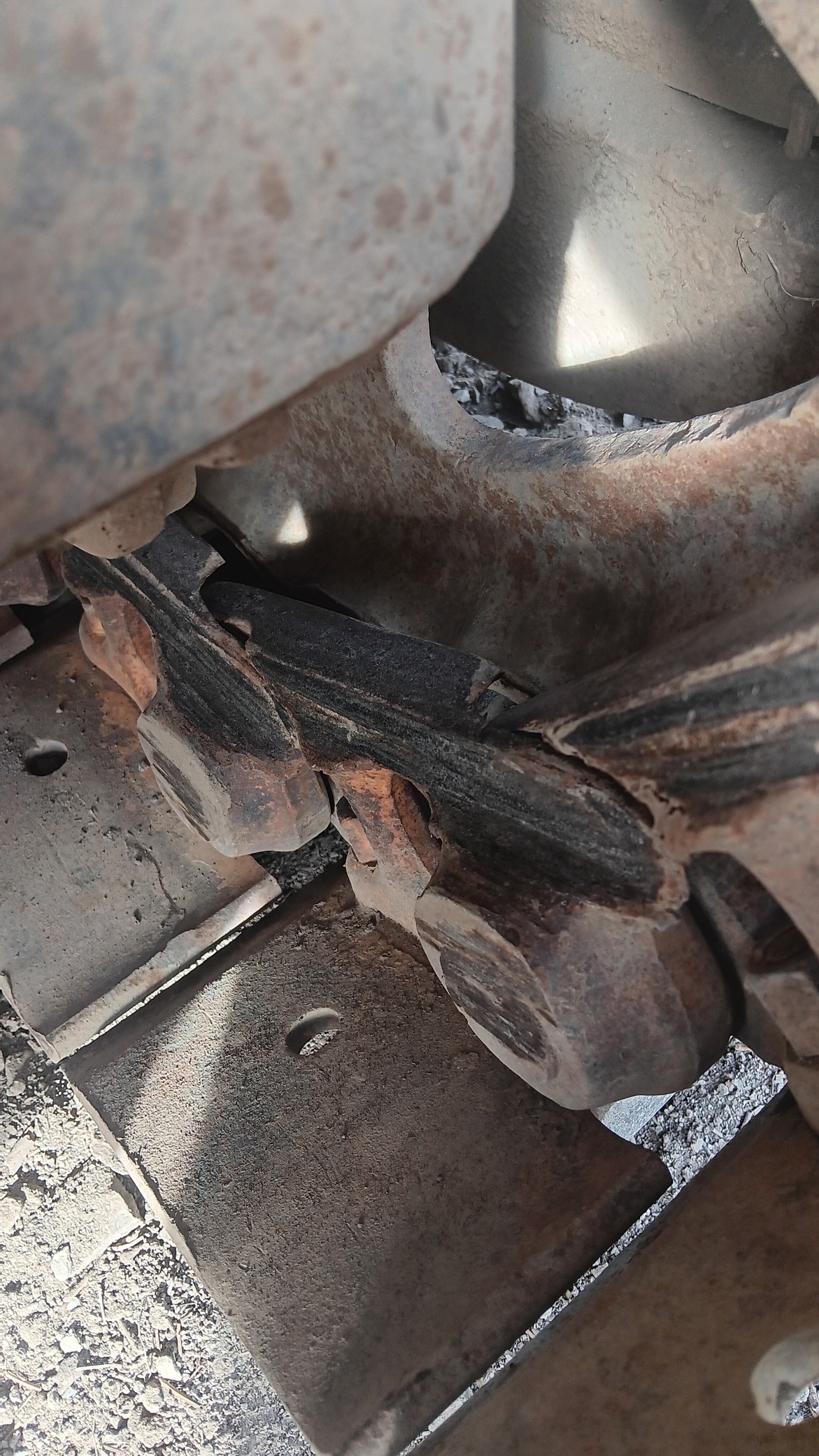

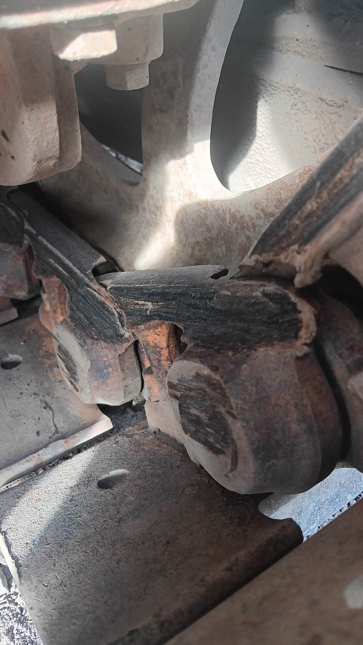

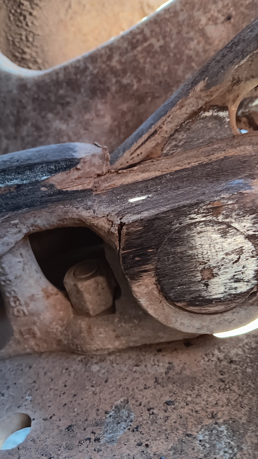

Since a new track chain could be hard to find, can it be resurfaced with 7018 or hard surface rod? Has anyone done this with success? I didn't see how bad the chain was wore on he backside of the right track, it was ran with a loose track. Looks like it started eating into the pin boss. I'm assuming it was loose track that accelerated the wear? advice, thanks.

It can be re surfaced. It is a lot of work. Your truck wheels will probably need resurfacing as well. It is the only thing to do if you can't find the parts.

top side of track chain can be built up - YET the problem is wear on pin and bushing , both outside of bushing and INTERNAL WEAR .
 I built up rail height on 37 link track on my HD5G and got about 2 years of use until I had a link fail as internal of chain was wore and excess slack rode up onto sprocket tooth .
 Check track length - measure ON CENTER of 1 link - then measure length between 4 links -pin to pin - find out how much wear by checking that against what 1 link on center is .

Coke, if I'm measuring correctly, I'm getting 6 1/2" from center of one pin to the next. 19 9/16" across 4 pins
I was hoping to avoid splitting the track and just welding in position, I jacked up loader and have the tracks free wheeling. It would be my first time splitting a track so I'm a bit anxious. Good or bad idea?

Not being a expert on track wear and picture can be deceiving, your chain looks in relatively good condition. So I would guess your roller are more at fault than the chain. AC roller are harder to weld on in that they have bearing inside rather than just bushing as the other brands did.

Thanks everyone. I got 11 out of 37 built up so far. I used 1/2" round bar I had laying around to save on time, stick rod and less heat buildup between passes. I hope this holds for a bit. The chain definitely has a few links that are not looking good. Im rotating the tracks with a ratchet strap and welding from the back corner.
