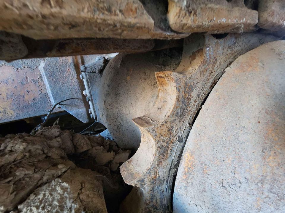

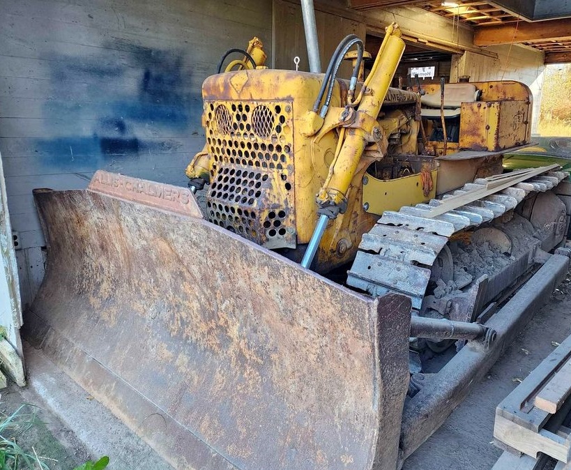

Post Options Post Options   Thanks (0) Thanks(0)   Quote erb224 Quote  Post ReplyReply Direct Link To This Post Posted: 31 May 2024 at 1:43pm
Maybe images will help...

Post Options Post Options   Thanks (0) Thanks(0)   Quote Les Kerf Quote  Post ReplyReply Direct Link To This Post Posted: 31 May 2024 at 2:04pm
That undercarriage is junk. No one makes new undercarriage parts for these, so unless you know of a source for some used, serviceable parts there isn't much life left in it.

Post Options Post Options   Thanks (0) Thanks(0)   Quote Coke-in-MN Quote  Post ReplyReply Direct Link To This Post Posted: 31 May 2024 at 2:28pm
How the bushing is after running on that sprocket is another question , if worn on both sides FORGET IT . Some IH track will work but that supply is also hard to find .
 Finding weld on sprocket rings next to impossible .

Post Options Post Options   Thanks (0) Thanks(0)   Quote Codger Quote  Post ReplyReply Direct Link To This Post Posted: 31 May 2024 at 2:44pm
In reality this is best a parts machine to keep others operational. Father Time has taken his toll on old AC machinery and although a very handy little dozer in it's day, that day has passed. All is not lost however. As I don't know your level of commitment, but a good welder/fabricator and skilled machinist willing to help out could make the track perform like new.  Lot of time and work but those sprockets and chains, (unless cracked) can be rebuilt to new specification. The chinese can replicate the pins and bushings as they did mine and they seem to be just as good as original parts at relatively reasonable pricing. Again, this will take quite a bit of time and commitment,  but can be done.
