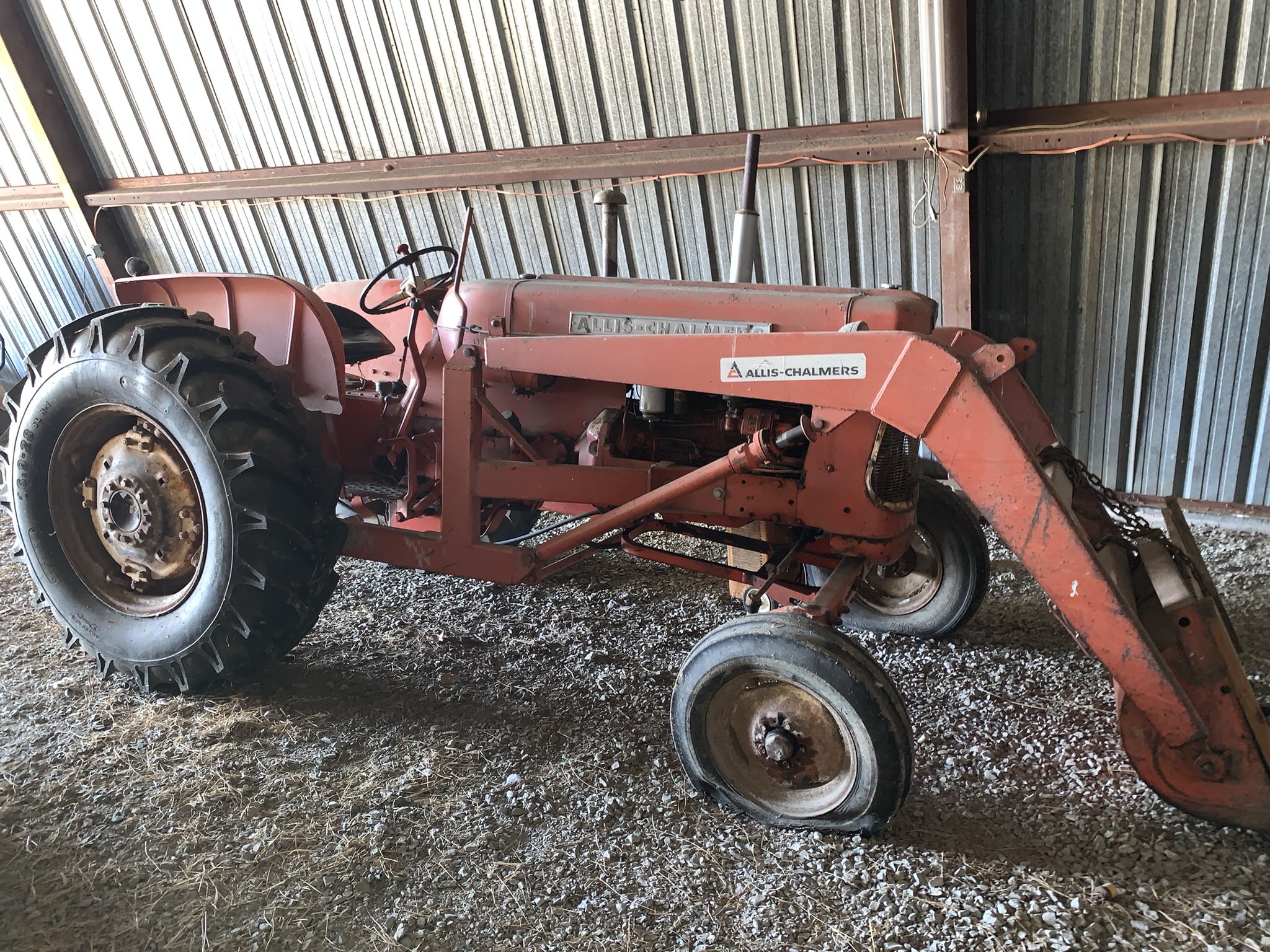

Hello, I recently found out that I'll be inheriting my late grandfathers 1961 D17 Series II with a front loader. Its been sitting in an equipment shed for the past 3 years untouched. The front tires are dry rotted and sitting on rims right now. I'm excited to own something he used on his farm for many years and overtime do a full restore. The catch is I've never operated much less owned a tractor and I'm not sure where to start with getting the D17 in a reliable running state or where to begin in identifying issues that need fixed.
I've purchased the Haynes Manual for the tractor and I have fair mechanical knowledge and tools at my disposal to tackle this project.
All that being said
1. Are there any other good knowledge resources or youtube videos/series that could be recommended?
2.  Aside from the obvious replacement of front tires where would y'all start to get the D17 running again after sitting for several years, and is there a published list of regular maintenance items for the tractor?

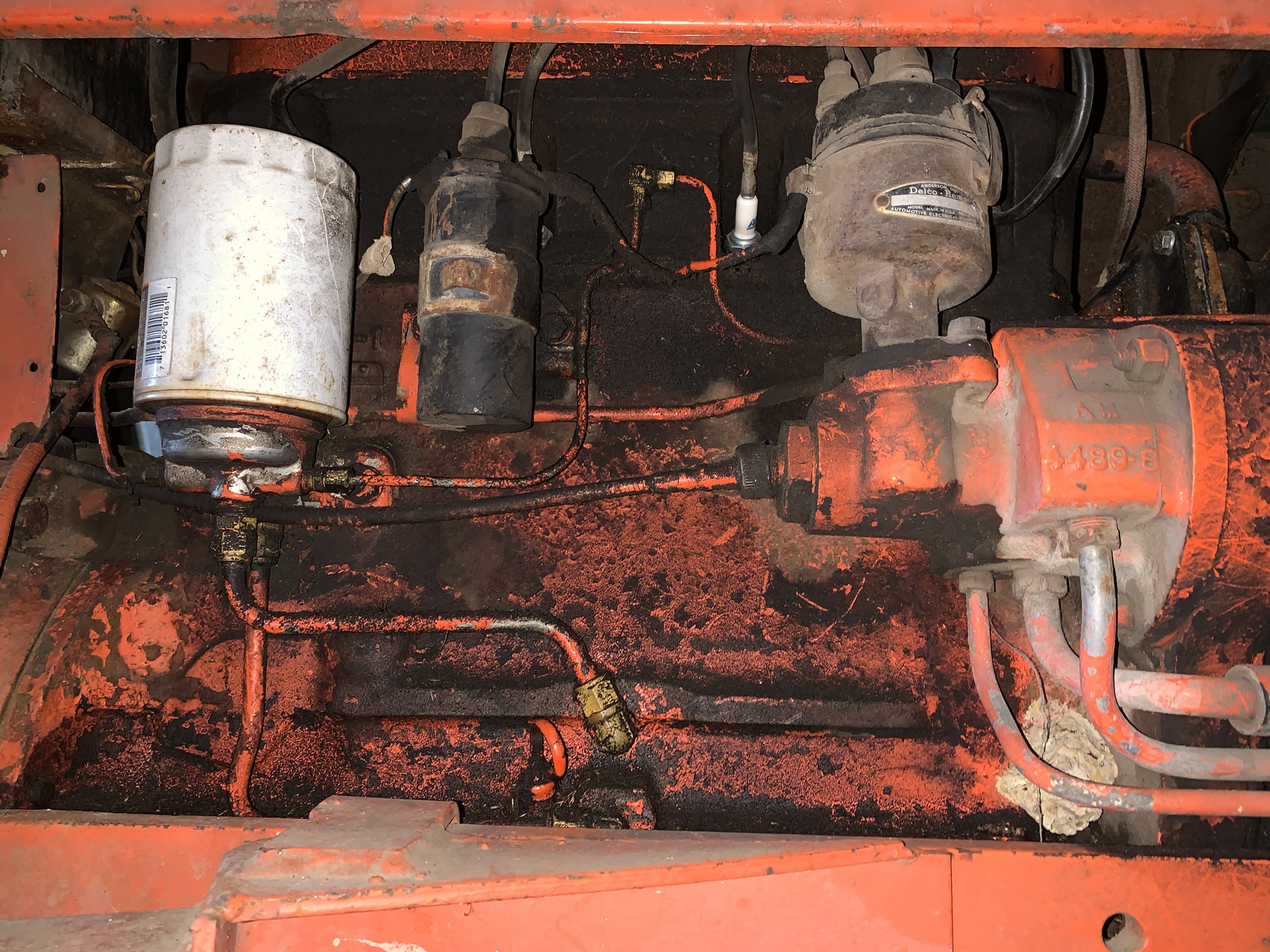

Additional info and images
Serial: D17 35728
Engine: 4 cylinder gas
Edited by mo_guy - 01 May 2024 at 7:36am

Appears to be 4 cylinder gas, I'll be up at the farm this weekend to bring it home and will have more pictures and easy access to answer questions.

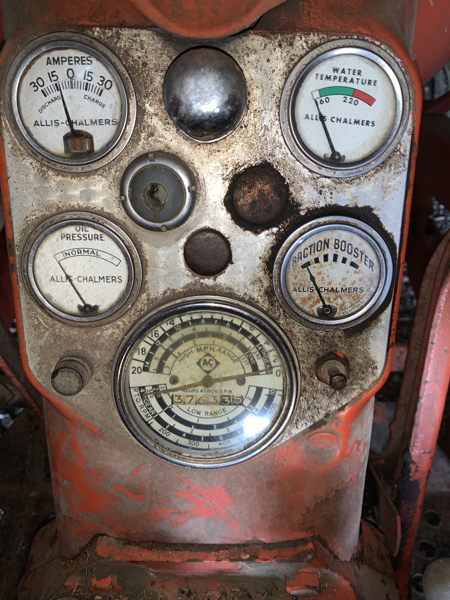

The serial number is "D17 35728" which should put it between '61-'62 Series II. Base on the engine block it appears to be 4 cylinder gas and I don't recall seeing an alternator on it. I plan on bringing it down to my property this weekend, will have easy access to answer any questions then.

mo_guy
Thanks for pics update.  Wow, you have yourself a great looking tractor.  Rear rubber looks new, fenders and sheet metal looks very well maintained

I agree, nice tractor. The traction booster gauge is even legible. My D 15 is also a 1961 year model. Good luck!
