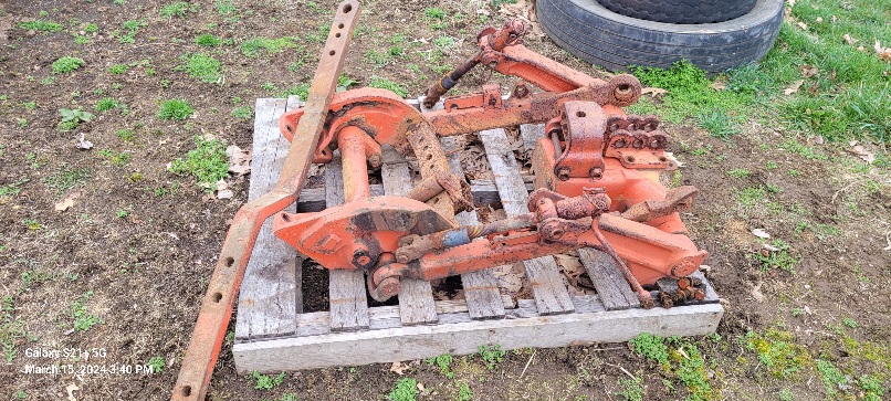

Post Options Post Options   Thanks (0) Thanks(0)   Quote Macon Rounds Quote  Post ReplyReply Direct Link To This Post Posted: 04 Apr 2024 at 8:51pm
Here is a 3 point assembly I recently Sold. I loosened the frozen threads....
As you can see by the torch marks.
Macon Rounds View Drop Down
Joined: 18 Feb 2010
Location: Pittsburgh Pa
Points: 2305
Post Options Post Options   Thanks (0) Thanks(0)   Quote Macon Rounds Quote  Post ReplyReply Direct Link To This Post Posted: 04 Apr 2024 at 8:55pm
I sent the jam nuts with the unit .
And
Had to replace one of the crank handles.
A royal PIA !!!
When you think you have it hot enough to punch out the roll pin, heat it more.
