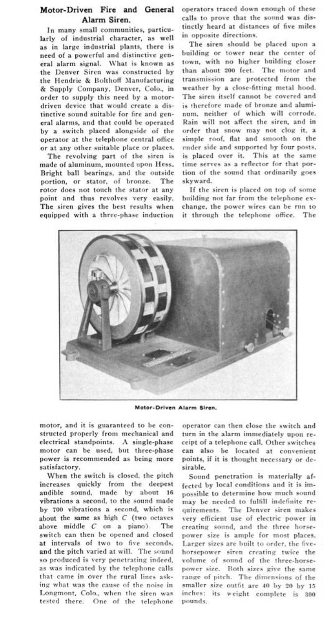

At the turn of the 20th century, steam was king in the world of allerting communications. That would all change in January 1915, when the Dillon-Box Iron Works company would introduce the electric motor driven "Denver Siren" to the world. Invented by company co founder William A Box, the siren came in 4 sizes, one small and one large 2 horsepower siren, and the larger 3 and 5 HP Duplex and Quadruplex models respectively.
Unknown to William at the time, his new invention would pave the way for over 100 years of allerting communications. The siren was an instant success, and by 1920 was in use in over 300 communities across the country, aswell as Europe, Australia and South America.

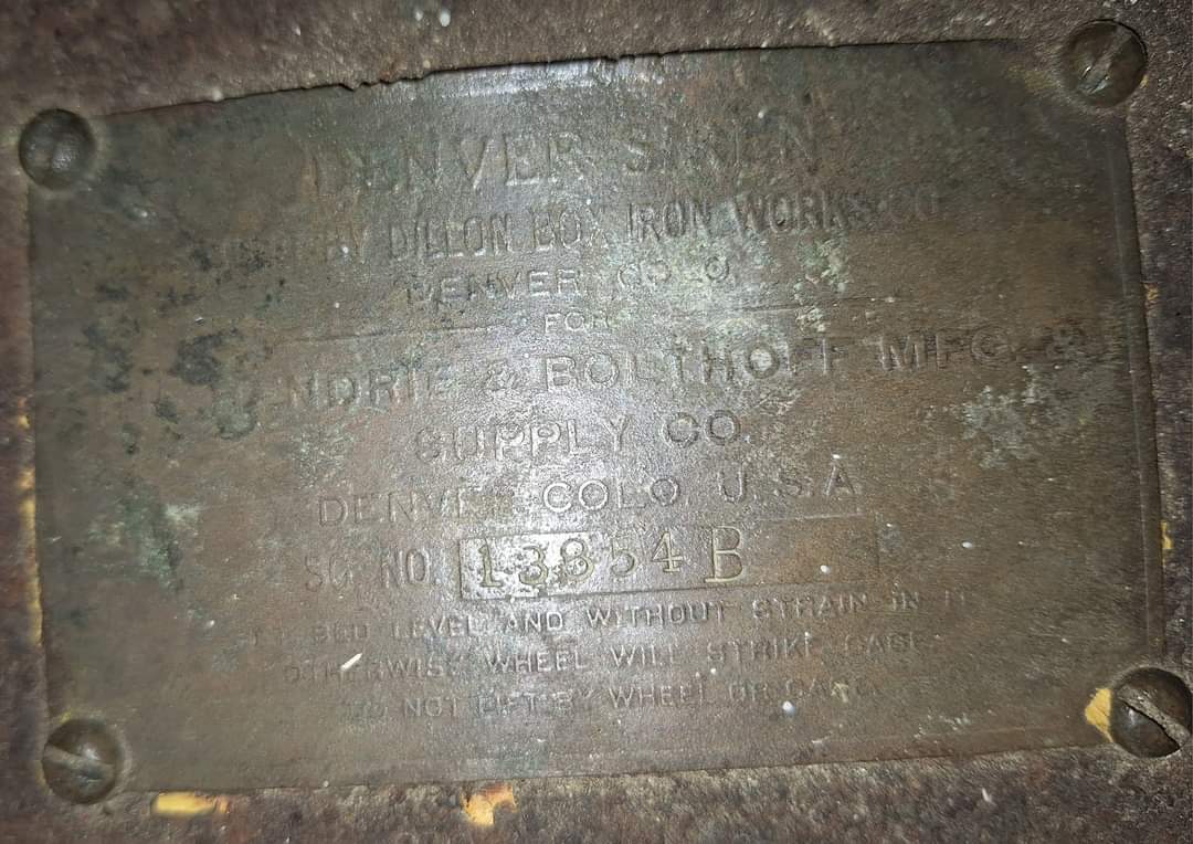

To efficiently mass produce and market these sirens, contracts were written with Hendrie and Bolthoff MFG and Supply Co of Denver, Northwestern Fire Apparatus of Spokane WA, American La France Co of NY, and Woodhouse Manufacturing Co, also of New York.
Today, there are about 50 of these sirens remaining, with numbers rapidly declining with each passing year.

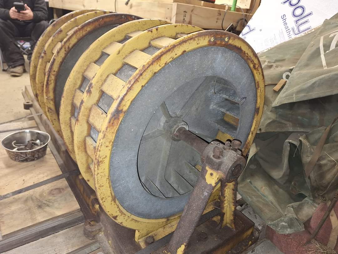

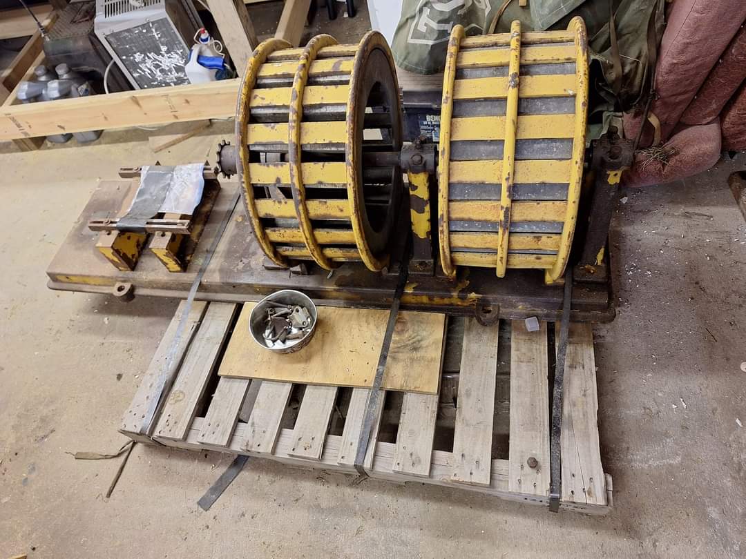

This particular "Quadruplex " model siren was saved from forgotten neglect in Albertson, North Carolina after serving for several decades as the village fire siren.

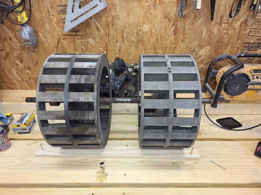

I had this massive 6' long 2' wide siren shipped to Michigan LTL last year, and began the restoration process. I have sourced a 5hp, 3 phase 1750rpm electric motor, as was standard for this model. The rearward fan has suffered some pretty bad hub damage, and will be sent off to a machine shop to have the broken area repaired.

The operation of the siren is deceptively simple.  There's a squirrel-cage blower fan... centrifugal blower, spinning inside a drum with holes cut in it.  As airflow is thrown outward, it compresses against the drum, but pressure is released suddenly when the vane passes a hole.  Make all the vanes line up with holes at the same time, and you have a siren.
Same technology is still used today... dead simple, incredibly effective and efficient.

I'd think a golf cart would be a bit small for this big boy. The pics are deceiving, it is 6 feet long, 2 feet wide and weighs every bit of 2000# with a motor. Interestingly, about 50% of that weight is in the cast iron base!

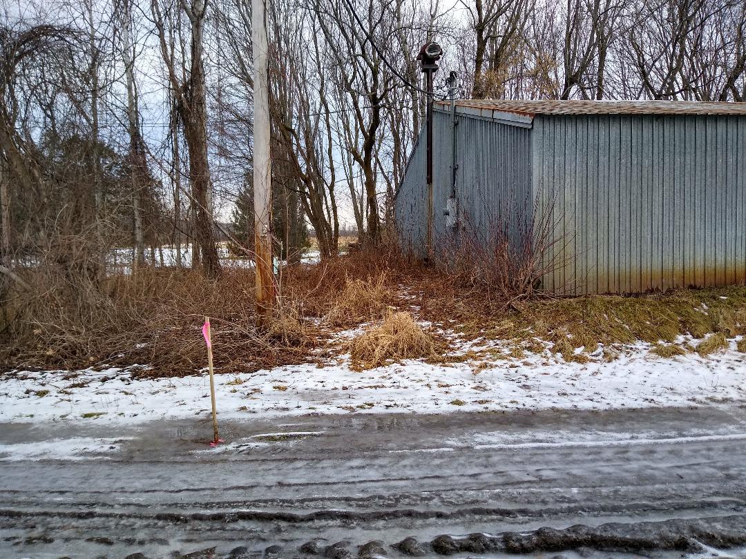

I know it's a terrible picture, but this is our local fire siren. It is attached to a warehouse that I bought several years ago. It is 3 phase (I believe 10 hp.). The building was built in the early 1960's. I have no idea if the siren was new then or moved from a previous location (which I suspect).
The warehouse was owned by a local slipper manufacturer (Shield's Slipper, which later became Bombay Slipper, then Wolverine Worldwide).
As a kid, we lived about 3 miles from the slipper factory. I can remember the siren blowing every morning at 7:30 (start of work), noon (lunch time), 12:30 (end of lunch) and 4 PM (quitting time). Even though we were 3 miles away (by road), we could clearly hear the siren.
The siren is still in use (much to my wife's dismay). It will have a home as long as I am alive.

WF owner, that is a Sterling model M siren built by Stelring Siren Fire Alarm in Rochester, NY. Judging by the vented horns, this unit was built after 1928. They made that model of M from 1919 until the 1960's at least. Sterling Siren Fire Alarm was a direct competitor to Dillon Box Iron Works.

The rotating assembly is machine balanced as a unit. Only spins about 1750 RPM. It will be bolted to a wheeled cart once finished to make loading it on a trailer easier.
