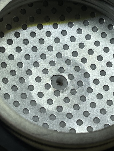

Post Options Post Options   Thanks (0) Thanks(0)   Quote JoeM(GA) Quote  Post ReplyReply Direct Link To This Post Posted: 23 Mar 2024 at 5:38pm
Originally posted by JoeM(GA) JoeM(GA) wrote:
Just a note on the filter prices, our local NAPA and O'reillys are getting $33-35 for the 57011/7011, Advanced Auto Parts has the C159 for sale online for $11.39, buying 4 gets you free freight, so I got 4 last Monday, with tax, worked out to $12.19 each. Got them in one day on UPS straight from Fram's whse in TN
Have you checked what's inside of the advance filter?Wink
looks to be the same as what's in my NAPA/Wix
first pic is the Fram C159 second is the Wix
I've ran both brands with no problems for over 25 years
on these bypass Allis tractors. Not a fan of the regular Fram filters, but I haven't had issue with these
