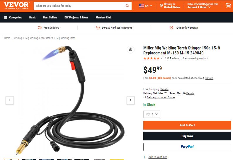

Son has a Miller 180 MIG welder about 20 years old... 10 ft gun / cable and the gas hose seems to be PINCHED as does not flow constantly.. I decided to get a 15 ft NEW cable... Looked on line and VEVOR had a buy for $50.  All the reviews were good.. I bought one and it came in this afternoon.... LOOKS GREAT.. ( this is the smaller gun used on the units up to 190.... NOT the 210  and bigger welders)..
Just wanted to post that if you have a MILLER and need a new gun/cable, this sure appears to be TOP QUALITY.. Heavy DUTY.. uses all MILLER consumables... Have not installed, but VISUALLY it looks GREAT! ------- photo shows a FLAME coming out of the gun instead of wire.... guess you cant win them all !  Wink

Must be using propane as a shielding gas!!! LOL

Ha! I was looking at clamp on handles for drills the other day, and saw one where they had clearly just taken random pictures of people using drills and photoshopped the handle they were selling onto the picture. Nobody was actually using the handle. Can't find it now that I'm looking for it.

VEVOR gun was a Perfect fit onto the Miller 180. Nice to have a 15 ft lead instead of the old 10 ft.  Gun is heavy duty and has a plastic spring on the machine end to keep the flexing to a minimum...Quality is better than the ORIGINAL Miller... BEST of all was the PRICE !!  Wink

I did a search and found this... I think it's the one you posted:
Now, I see that it has conflicting ratings... in one place, it says 150A at 60% duty, but doesn't specify duty cycle of the other ratings... it shows 100A for CO2, and 60A mixed... it shows 0.030 and 0.035" wire...

The Original Miller Factory gun is 100amp rated.. This Aftermarket is 150 amp at 60%.. Dont see us ever getting even CLOSE to that . This is home repairs of truck / tractor / equipment. I might weld for 10 minutes straight (seldom), but then its time to position more parts and setup.. Probably rarely go over 50% weld time... and not even close to 150 amps........... Gun sleeve is setup for .030 or .035 wire... Son has a 10# roll of .035 in his machine ...
Remember this is a Miller 180 ( 180 amps max) and that is probably 40% duty.. so the gun is rated close to the welder capacity and WAY above the original cable...first thing i did when we got the machine was put a BIGGER 240v cable and BIGGER ground cable with BIGGER clamp... Probably twice the capacity of the Original Miller !!  Big smile
