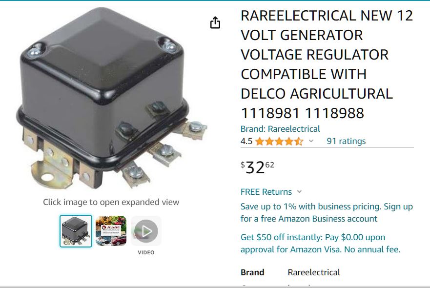

Post Options Post Options   Thanks (0) Thanks(0)   Quote steve(ill) Quote  Post ReplyReply Direct Link To This Post Posted: 22 Feb 2024 at 12:25pm
I bought this regulator and put on a "B" 6 months ago. It is 12v and says 7-9 amp. It does have the "L" terminal that is not used. The "G" terminal is on the bottom, not the side........... from AMAZON
I think Steiners is ABC154... or ABC185
