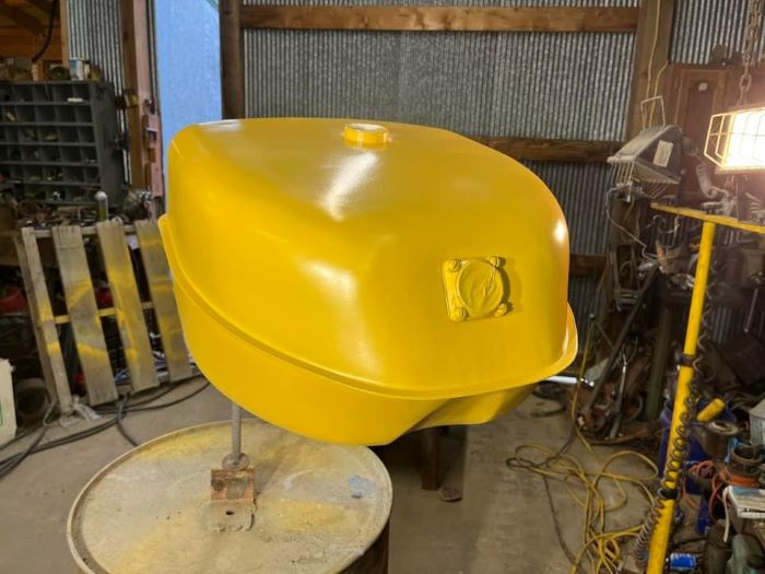

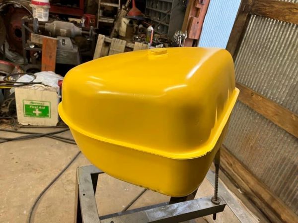

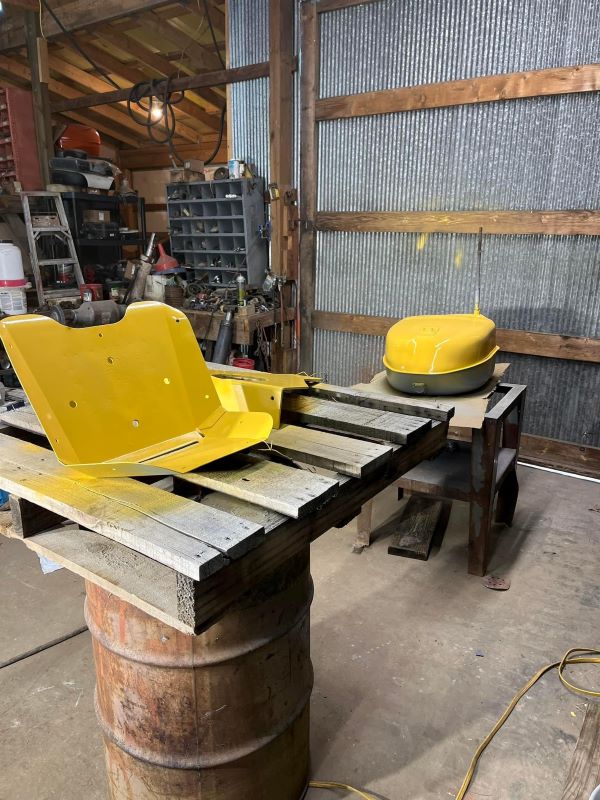

Line and painted a couple gas tanks for the I 615 and RL 415.

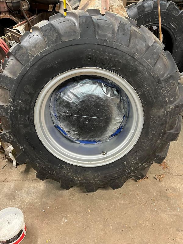

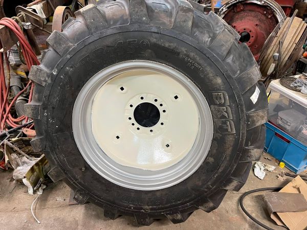

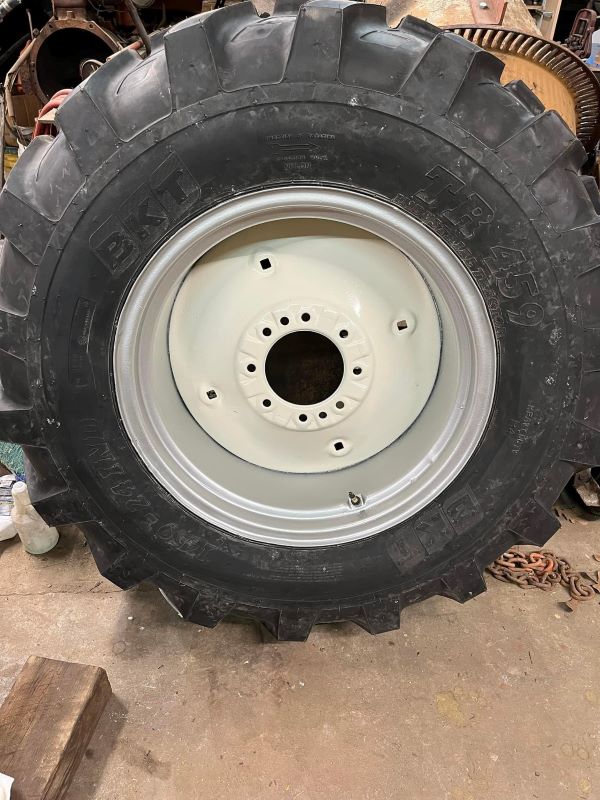

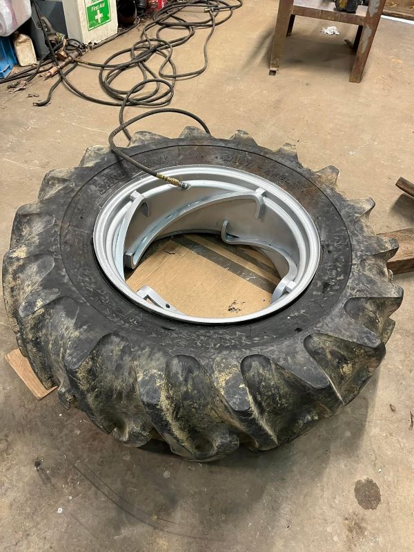

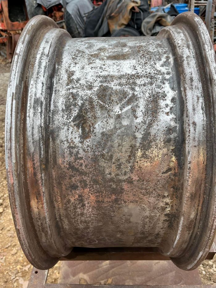

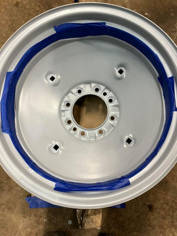

Also, took the old tires off and clean up rims and put new tires on.

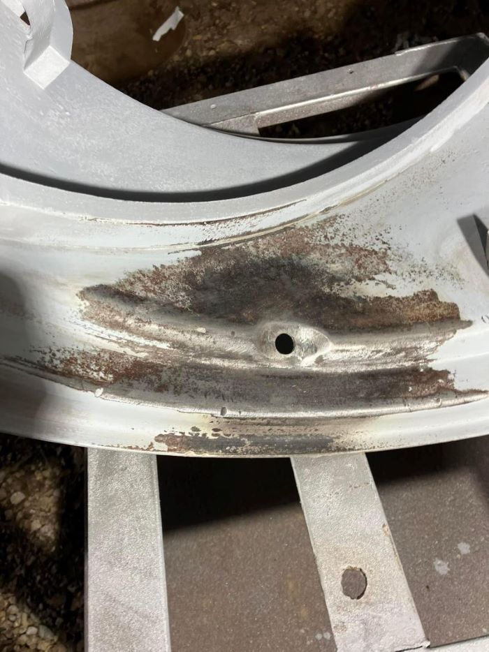

Almost forgot to put a new location for the valve core hole.

How do you make the flat spot in the rim for the new valve stem?

I use a torch and heat the area up red, use a piece of wood under the rim to support and a piece of metal as wide the one use to be there and hit with hammer.
I’ve done that also

Post Options Post Options   Thanks (0) Thanks(0)   Quote PaulB Quote  Post ReplyReply Direct Link To This Post Posted: 13 Feb 2024 at 12:22pm
When I have a rusted out valve stem hole, I just weld in a washer.
