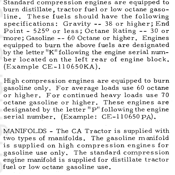

Hello, I am unsure of what fuel type to use. I see in the manual it depends on if I have a standard or high compression manifold (pic attached). I am not sure how to tell.
Is plain normal gasoline acceptable?
Thanks

Yes, any good, clean gas will do.
