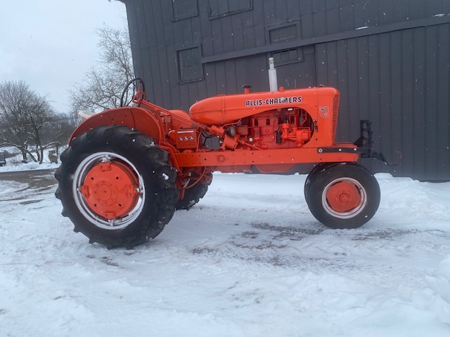

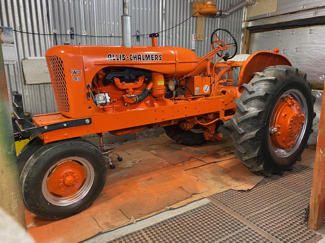

Let’s call her Sam’s Sister. Sam was last weeks project and was this winter’s sixth project. Sis is number 7.
All oils changed.
HD red antifreeze per the Dr.
Front rim welded some cracks, serviced both front wheel bearings
Professionally rebuilt Marvel carb
New Denso alternator,diode on IG terminal, wiring and voltmeter
New key switch
New power steering hoses
Cleaned degreaser primed and painted rims and where needed
Plugs points wires cap and rotor all new
Timing done,
Compression check dry cold : 149,149,142,149
That’s about all she needed.

That is a very nice tractor.

I'm guessing it has d17 pistons to have that kind of compression numbers.Nice ole 45 for sure.

Could be M&W's too.
Very nice Captain!

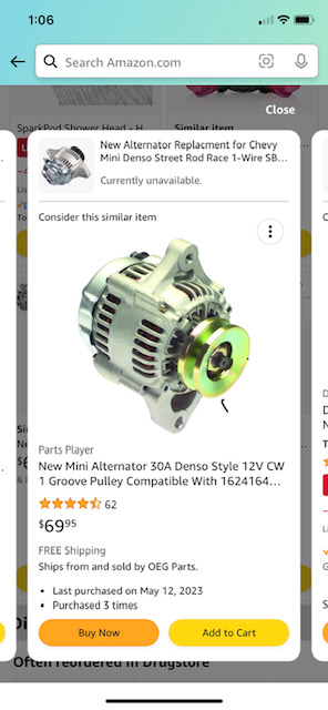

What brand of red coolant are you using? And what is the Denso alt number? Thx. Sure looks good!! Smile

Post Options Post Options   Thanks (1) Thanks(1)   Quote captaindana Quote  Post ReplyReply Direct Link To This Post Posted: 10 Jan 2024 at 12:10pm
Think it’s command from local auto store heavy duty truck says good for million miles or So

That sure is purdy Capn.  You sure are having fun this year aren't you?  Yeah, I'd say just by looking that it was built as a pulling tractor.

I sure know one thing….. I wish they could talk! This tractor had a real fine screen soldered or brazed around the air intake end. It was professionally attached, I had a heck of a time removing it. And the build up of baked on dirt and grime on the inside of that pipe, maybe a solid 1/8 + “was like none I have ever seen. Dang I wish she’d talk!
