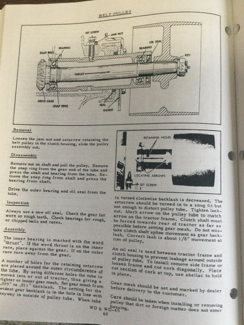

Post Options Post Options   Thanks (0) Thanks(0)   Quote Ed (Ont) Quote  Post ReplyReply Direct Link To This Post Posted: 30 Dec 2023 at 2:32pm
From service manual.

Thanks. I'll take another look.

Post Options Post Options   Thanks (0) Thanks(0)   Quote StanGreen Quote  Post ReplyReply Direct Link To This Post Posted: 30 Dec 2023 at 6:39pm
Yeah, the service manual is clear as mud.LOL I may have to read it a few time to figure out what it is trying to say.

Post Options Post Options   Thanks (0) Thanks(0)   Quote Ed (Ont) Quote  Post ReplyReply Direct Link To This Post Posted: 30 Dec 2023 at 6:54pm
I am no expert on this. Have never done it. I do have a belt pulley on mine and the alignment marks are visible - on top of frame rail straight above the pulley tube. Mine were also covered with paint. Then find the marks in the middle of pulley tube. The retaining set screw gives you the gear mesh. Kinda like setting a diff. They want .005-.011 freeplay -same as a diff. I hope Doc or others see this and can clarify this for you.

Post Options Post Options   Thanks (0) Thanks(0)   Quote Dennis J OPKs Quote  Post ReplyReply Direct Link To This Post Posted: 30 Dec 2023 at 7:06pm
Others will chime in.  In the manual it says the dealer does the mark on the frame and the pulley.  So, if you have a pulley not mated to your tractor the gear mesh will be a trial & error approach to see which hole in the pulley best gives you the proper gear mesh.  Also, have your tractor tilted on at least an 8 inch block with the wheels in.  Otherwise, when you pull that plug you'll have oil everywhere unless your oil level is low.  Good luck.

Belt pulleys were an option. No belt pulley-no marking.
